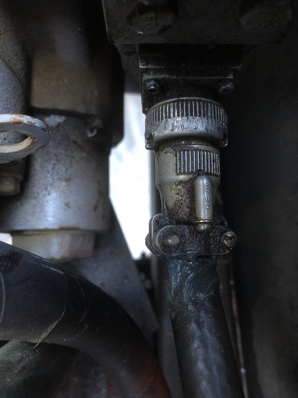

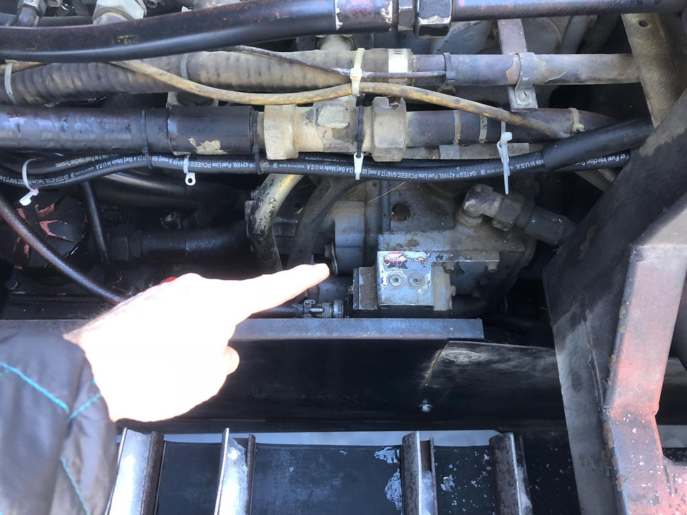

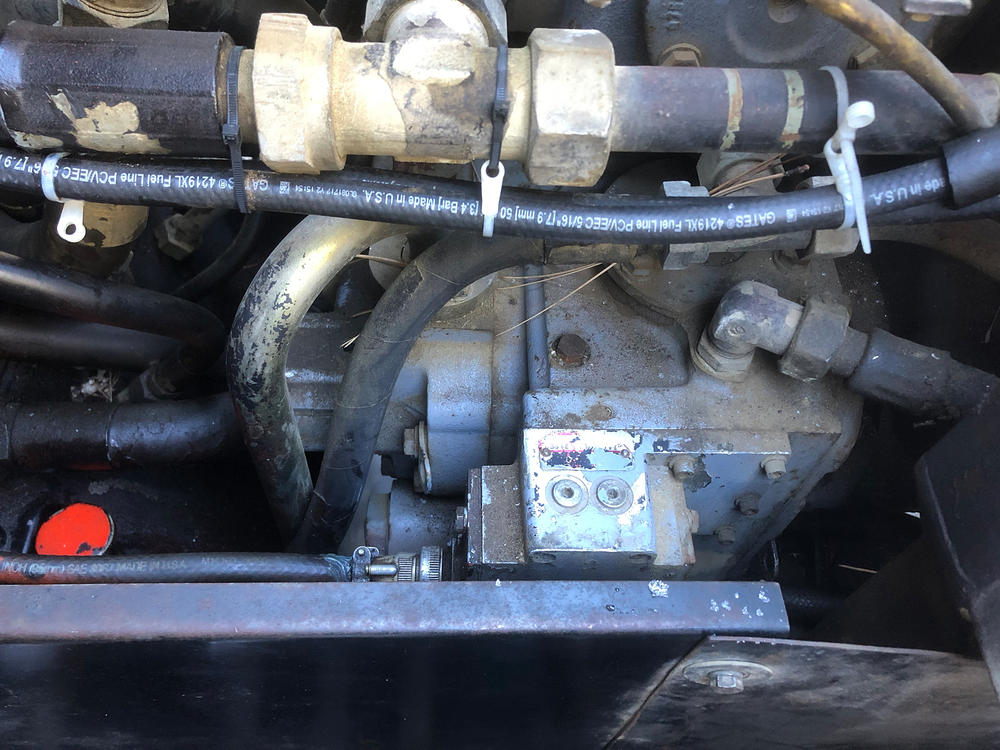

We have begun having consistent steering issues with this early 80's PB 270 after 10 minutes of warm up with the machine pulling left. Early tests appear to be a faulty Moog Controller. Here are some rough pics of the left side controller. Checking on long shot if someone may have source to one, or perhaps where a Moog Controller could be rebuilt, besides sending it to Moog. The machine is located in WA state. Thanks for any insight.

Have you tried calling Pisten Bully in Oregon or Reno? I had one(Moog) fail on me about 5 years ago or so and as I recall Pisten Bully in Reno sent me to a company in California that sold me a reconditioned Moog. I don't remember the price but it was pretty reasonable for my needs. Also if you don't use your tiller it maybe possible to swap out the one on your tiller pump for the drive that is causing problems. Again PB tech support is the first place I would turn to for help.
Thanks for the suggestions! We are using the tiller, but may swap to confirm. I have spoken to Rod down in Reno a number of times on other issues, I will try reaching out to him again. If I find a Moog rebuild source, or if someone has one, I'll be sure to post.

UPDATE: Just finished the repair on the Moog Servo Controller with Jack McGowan / McGowan Controls. Jack was great! He educated me on controllers and they repaired the controller in one day. In my case it was a broken internal wire. Complete service was a flat rate $545.00. Thanks again for this lead and here is the information if it can be of help to others:
