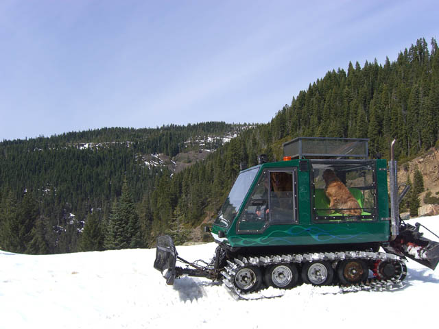

Whats the name/brand of your cat... looks like the smaller size ones...
Just got back from hunting snow - it's going away fast in Plumas County.
Nikson - it's a 1988 Prinoth T2. Seats 8 (or 2 people and 3 ridiculously huge dogs). 6 Cyl VM Diesel, turbo, 140 hp. Hydrostatic transmission, 8-way blade, tiller. It's a capable little cat, not a ton of cargo space though. Track pressure = 0.74 psi. Top speed is supposed to be ~17 mph. No speedometer, can't tell. Nice seats, though. And you can't beat the visibility.

If you could/can - please post some more pictures of the cat itself (inside/outside) - better detail of everything and how its figured.
I've been thinking of building one with hydrodrive - just not savvy enough to know they hydrolic part of the configuration, like the size of motors/pumps/engines that are needed to run the setup.
My schedule says it'll be 3 weeks until I get back up the hill for a photo op, but I'll take a few pics and try to give an idea of what's going on.
It sounds like your Toyota Diesel powerplant would be a good starting point. From there, I think it's a matter of resourcefulness and resources. The Hydraulic pump is a variable double pump Hydromatik A5VG40DG1DG1. That pushes through 2 Hydromatik A6V55HD hydraulic motors, which turn the Lohmann GFR 053E 2515 wheel hub motors, which house the hydraulically released spring-operated multi-disc brakes. Pilot-pressure proportional-directional control valves are similar to David Brown http://www.davidbrownhydraulics.com/detail.aspx?ranproid=87 The A6V55HD motors have a Bosch-Rexroth counterpart in the A6VM55HD, check out http://www.boschrexroth-us.com/coun...iston_units/a_downloads/ra91604-a_2009-07.pdf You can probably track the other stuff down - I think Hydromatik is now Bosch/Rexroth, so the twin pump may still be around. I'd bet they probably make something real similar to the Lohmann wheel hub motors, too.
Once you get the motive power figured out, you've already played with drive sprockets, wheels, tracks and suspension. Build a frame, add a seat, and you're good to go. :brows: Motive power, and a whole lot of hydraulic hoses. Like spaghetti.
Seriously, if you need them, I can scan a couple of schematics to pdf, although they don't help a whole lot. They're really made for what to anticipate when you look under the hood. Maybe around the time I shoot some pics, I'll do the scans unless you need them sooner. But like I said, they don't help a lot until you can actually put an eyeball on things.
