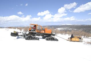

There is a Tucker for sale in Colorado and the price seems reasonable but others may not agree. It comes with a blade and some sort of groomer. It is a newer version(2000 series?) and looks like it has the bigger tracks but I'm no Tucker expert.
http://www.resortboneyard.com/list.php?category=9
That Tucker looks lovely, but a bit on the large side, I think.
