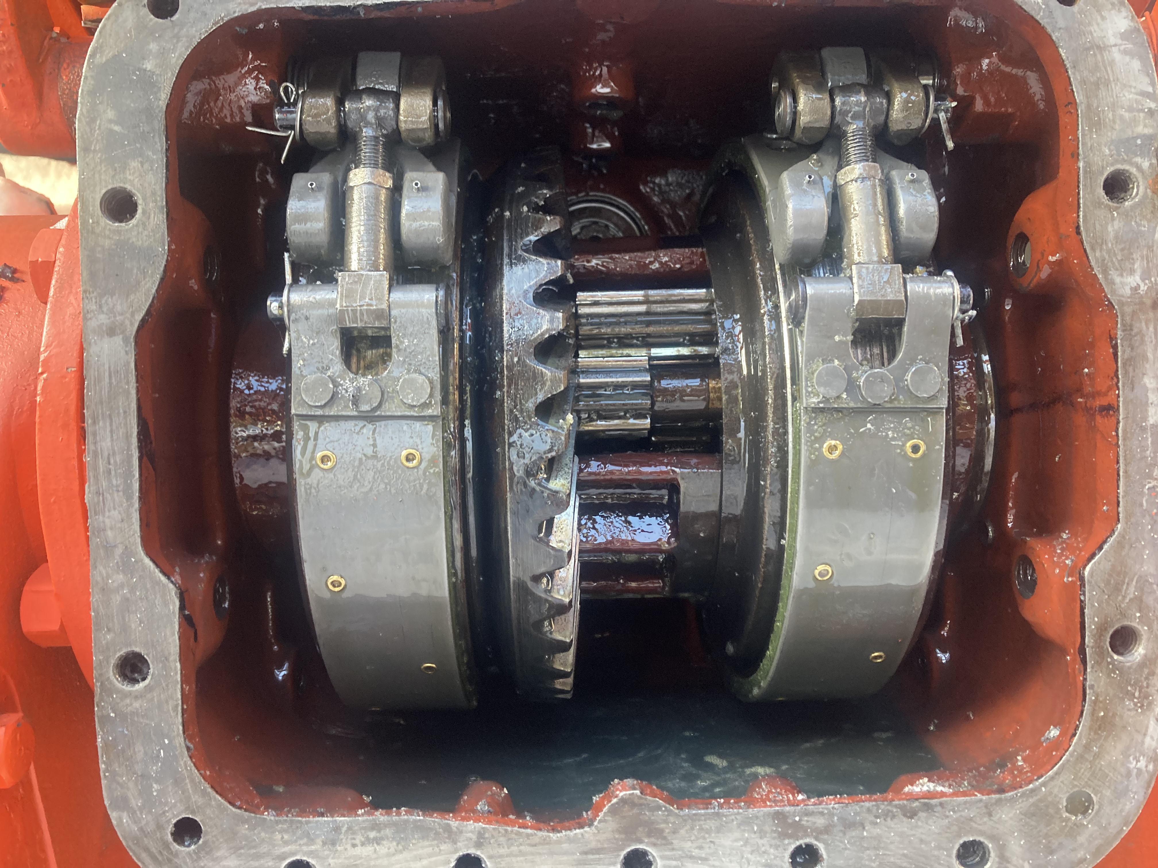

I’ve got a 1201A with the oc4. New pads from spryte improvement, to4 spec oil.
When cold wet brakes function well enough. Wants rear end warms up, less than a mile, steering performance tanks severely, to the point I have to reverse to make a turn. They become soft and squishy to the point they don’t even bite. Performance is maintained in reverse for some reason. Once it cools, basically back to normal.
The rearend is not over heating and I am pulsing brakes like you’re supposed to
My thoughts are it’s gotta be the oil. From those more experienced with tearing these oc4 s apart, what else could it be?

Tried backing off the bands via exterior adjustment. No change. Works well enough cold but quickly becomes squishy after 1/2 mi to the point they are useless.
I’ve got to head back down the hill but will consider pulling cover when I get back
if they are internally too tight I am not sure the outside matters. but yes a quick peek is in order
Might the same be said if they are internally too lose?
When peeking inside see if the bands fully conform to the drum. Relined brake bands are hard to get tight enough initially. Once used for a while and the band conforms to the drum, they become easier to (internally) tighten.
When the brakes at applied going forward, the friction between the brake lining and drum decreases the tension in the brake band and in reverse it increases it (might have the forward & reverse swapped). Speculation here - if the bands are too loose maybe when the oil is cold its viscous enough for the lining to grip the drum when going forward and brake but not after it warms. Since the band tension increases when braking in reverse, the oil viscosity may not matter much.
When you figure this one out please post what you discovered.

Ok, I had a chance to go through the machine this week. Here’s what I found:
-cylinders are working perfectly and bled to perfection
-confirmed no gl additives in oil
-no apparent interference from levers contacting dash
-oil level in diff was good however one side drop box had excess. Pat said this isn’t uncommon and has seen a Dropbox fill to top without consequence provided the oil level in the diff is maintained

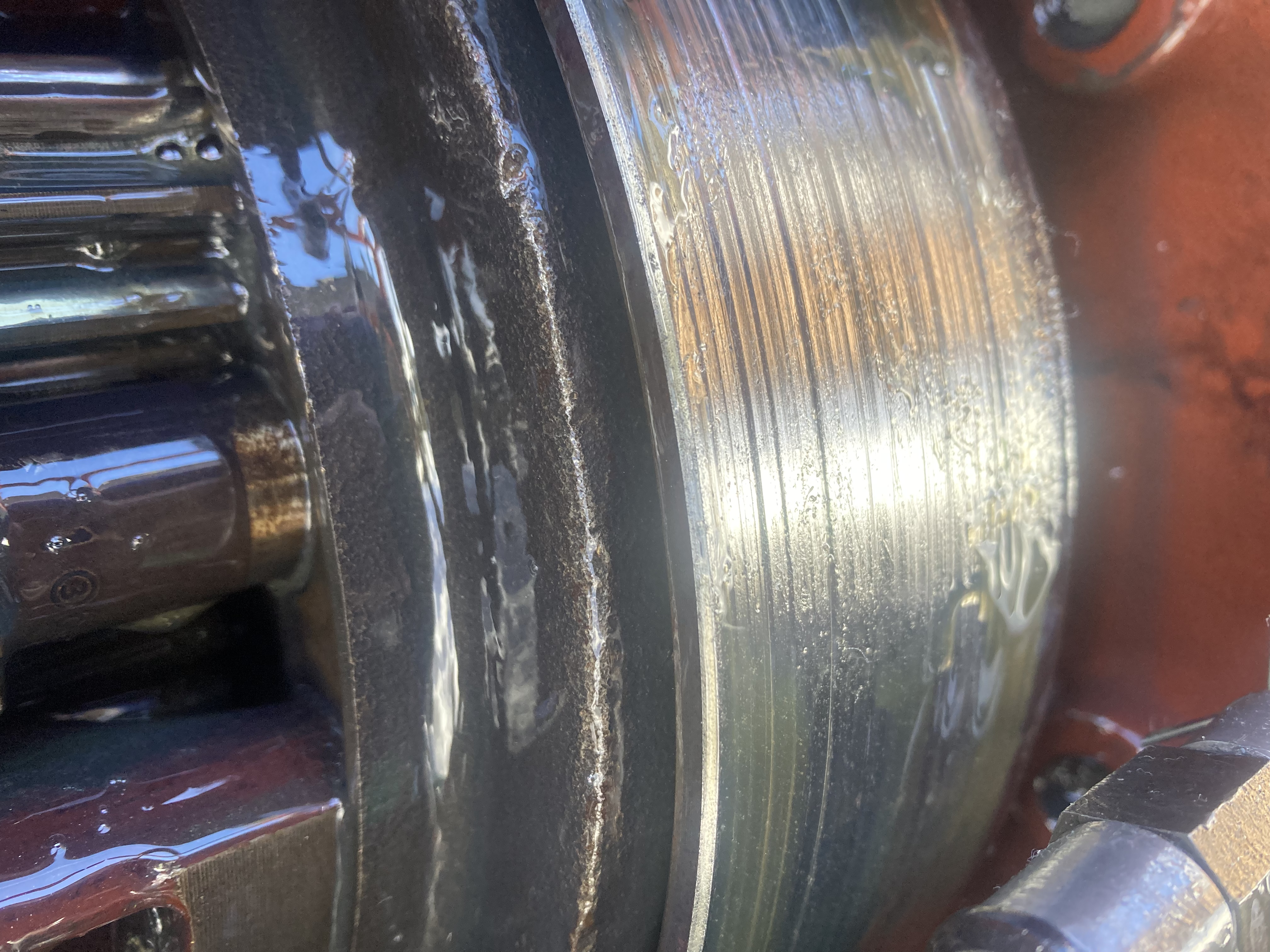

-pulled cover and the new bands had loosened a bit after break in. I was able to tighten each side another 3/8”
- drums are scored but not particularly worn when compared to portion that doesn’t contact pads
- pads still look new
Refilled with 10-30w for now, tightened external brake adjustment and took for a spin.
