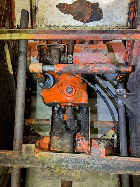

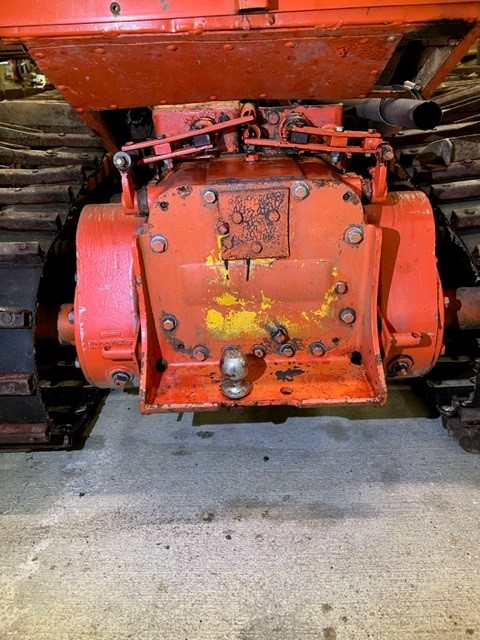

Hi...forum newbie here...I have a 1965(?) Spryte 1200 with OC-4 transaxle...have been told both 50W oil and also 10W hydraulic oil are required in the gearbox...just took the rotten wood deck off today and someone has written in paint pen on top of the gearbox "50W Only"...just want to be sure, what is the correct oil for the transaxle? I am in NH and this will be used only in winter temperatures...
Also, is there a source to buy a 1200 manual? I've found a couple 1200C on-line, but not a 1200?

Thanks!

I've rebuilt too many of these to recommend anything other than SAE 50 weight transmission oil. (SAE 30 weight if its below 0 degrees F ambient) in the OC4, drop boxes too. The wear on the ring and pinion is severe in these.
Just my opinion, use what brand you want, I'll stick with Cat TO-4

My 1402 has the same transmission/axle but without drop boxes. The manual says "Above 0° F SAE 50 wt engine oil, heavy duty". (Below 0° SAE 30) The best source for that is aircraft engine break in oil. If that is not available the book says you can use "SAE 90 straight mineral gear lube, parafin base, inhibited." My cat had T 04 in it when I bought it. I switched to 50 wt mineral 9 years ago with no issues. It seems to be more responsive in steering. I don't have to pull the levers as hard. Of course my cat is much smaller with only 30 hp. Typical operating temps for us are 5 - 35° F. The main thing is to only use a GL1 type oil (no high pressure additives or sufides). The phosphate additives will corrode the bronze bearings in the gearbox. In other words, if it stinks like sulfur, don't use it.
