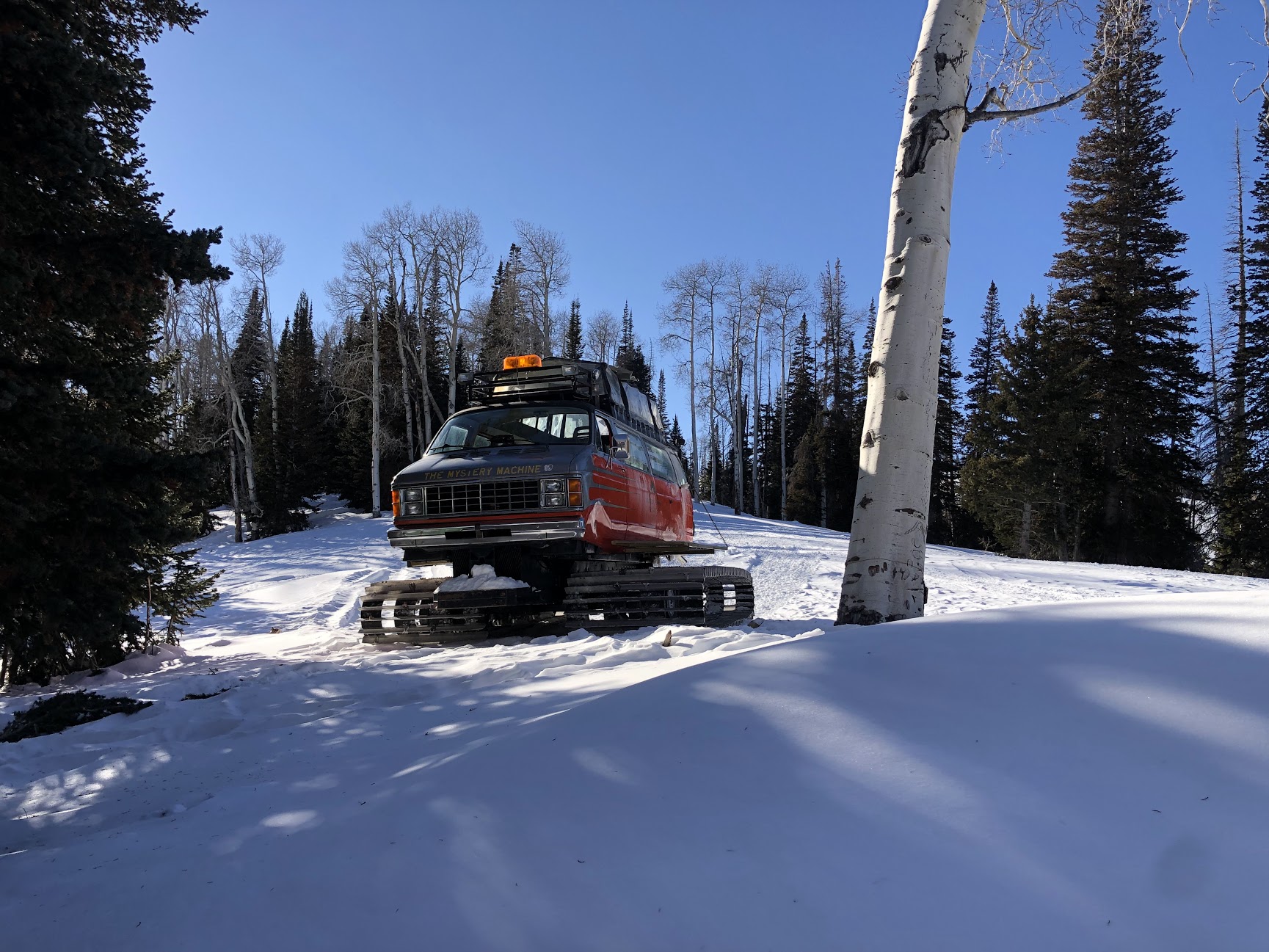

We semi-recently ended up doing a trade on one of our old Imps ('64 1404) and got the Vancat that many may have seen listed on KSL or here on the forum.
It's a monster of a machine, reminds me of a monster truck with the tracks on. I believe the base is a 2100c. Its got a ford 391 V8 with a C6 automatic transmission and the OC-12 rear end. We're thinking of potentially doing an engine swap on it and wanted some of your experience and wisdom.
The goal of this machine is to make it into a reliable cabin transporter. Cabin is 6 ish miles on the snow with some decent inclines and lots of drifting snow. Right now it doesn't have a plow on the front and I'm wondering if throwing a plow on the front + having passengers will be too much for the OC-12.
First question: Can the OC-12 handle 12 people and a plow on the front? I don't think it will regularly be loaded with 12 people, but it does have the room for it.
Second question: What do you think about an engine swap for a little more power, reliability, and availability of parts? We were thinking maybe a 6bt or a Deutz air cooled engine. Maybe even a modified 4bt. If you have any other suggestions let me know.
I would love to get some of your thoughts on this. Thanks in advance.

Thanks so much for the replies! I guess I’m not as concerned about the passengers as I am about the plow. This cat has already carried a decent amount of people and gear and has done fine, but it has not had a plow. I’m wondering if the combination of the passengers and gear + the plow would be excessive. It wouldn’t be used to bull doze piles of snow, it would be for cutting drifts. The loads it would carry are passengers and gear, potentially a decent amount (max of 14 passengers + gear). I’ve heard many things from people with no experience in the snowcat area that plows are dangerous as they put a large load on the rear diff. This is coming from a truck application and I’m not sure how much it applies here, but I do assume that the weight of the plow and the amount of snow pushed does add some load to the diff.
As far as the engine goes, there is some worry about it. When we got it the oil pump was seized. They said that they had turned it off immediately after seeing the loss in oil pressure, but who knows. Not sure why the oil pump seized in the first place. Upon replacing it we saw that they had installed the shaft in upside down, so not sure if that contributed or not. Bottom line is that we probably are going to want to rebuild it soon for peace of mind and the thought was that if we were going to take the time and money to do that, we may as well switch to a strong, reliable power plant. Love the idea of a turbo-diesel with that low end torque for those steep hills.
As of right now, the ford 391 I’m guessing is around 700lb (please correct me if I’m wrong, I can’t find much info on it) where a 4bt is 750-800. So I’m not too worried about the weight (maybe I should be).
The OC-12 we have does have the drop down boxes, not sure if that affects anything.
We’re not attempting to make a hotrod or get a massive amount of power in there. We’re more concerned with just getting something that is a little more common so parts and info aren’t impossible to find, and that is reliable, bulletproof if possible and can easily handle the load of the passengers and a snowplow.

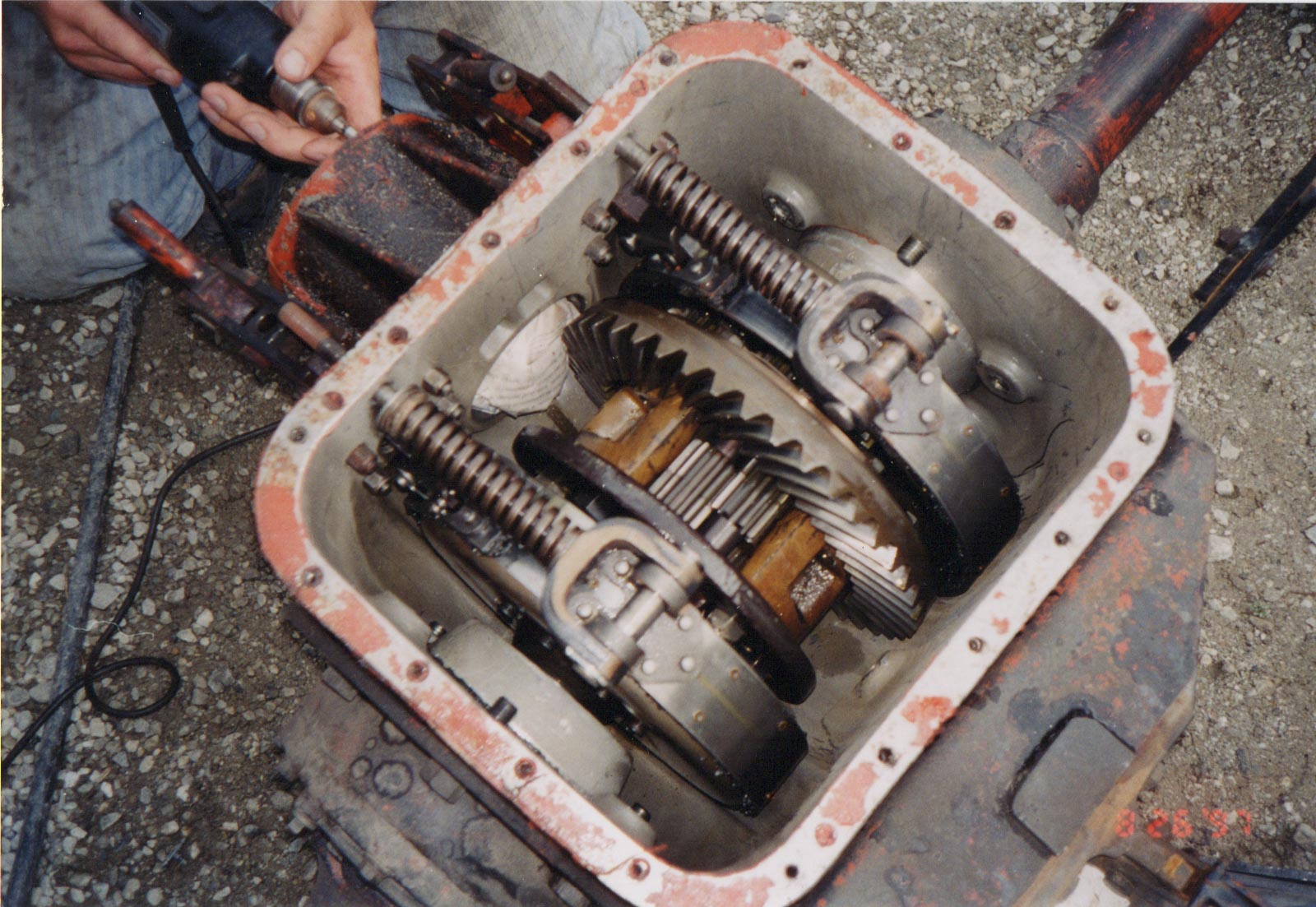

The OC-12 Box is damned tough.
Big thing with these is to be sure that the bearings are all in good order and that the oil stays water free.
Snow water is the softest water on the planet and can find it's way into things.
Rusted bearings WILL FAIL....

The Ring and pinion in the OC-12 are good sized and the gears in the drop boxes are huge.......
Axles are herky as well.....
Some early axles had a snap ring holding the axle bearing on.....The axles saw some breakage at the snap ring groove...
All newer axle bearings were held on by a press fit collar.
If you break an OC-12 YOU ARE in waaaaaay too far......

The innards of the OC12 are tough...but like any mechanic gear box....things do wear.
Make sure the bronze bushings in the equalizer are in good shape and also the inner pinion teeth are not worn badly.....
Standard inspection of the ring and pinion for chipped or broken teeth should be done.
The thrust washers "AS delivered" are cheezy as are the washers behind the heads of the inner pinions.
These issues are easily dealt with.
Oil choices are a bit critical...DO NOT use 85/140 gear oil.
There are many good "Tractor fluids" in a 30wt that work sweet and are designed for use with friction bands.
IF your OC-12 has been worked on ......it likely uses the main box oil to also flow into the drop boxes and the axle bearings too....
The previously mentioned "Thrust washers" have a habit of chewing up and the pieces get ground to bits by the R&P and the resulting trash goes through the bearings and raises hell....
My OC-12 had a couple bearings that had actually fractured due to the junk...
