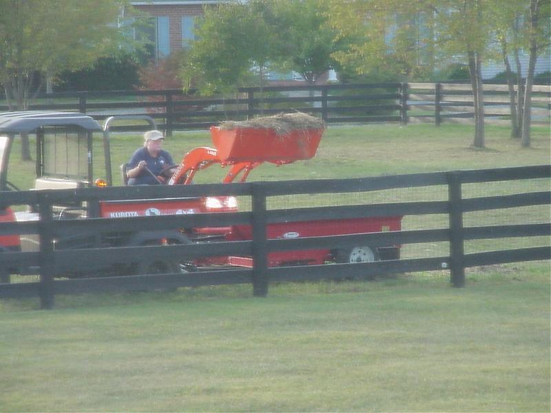

It does fine with drawbar type implements too. Here's ours pulling a manure spreader. It does fine with the drag harrow too.
Jim
