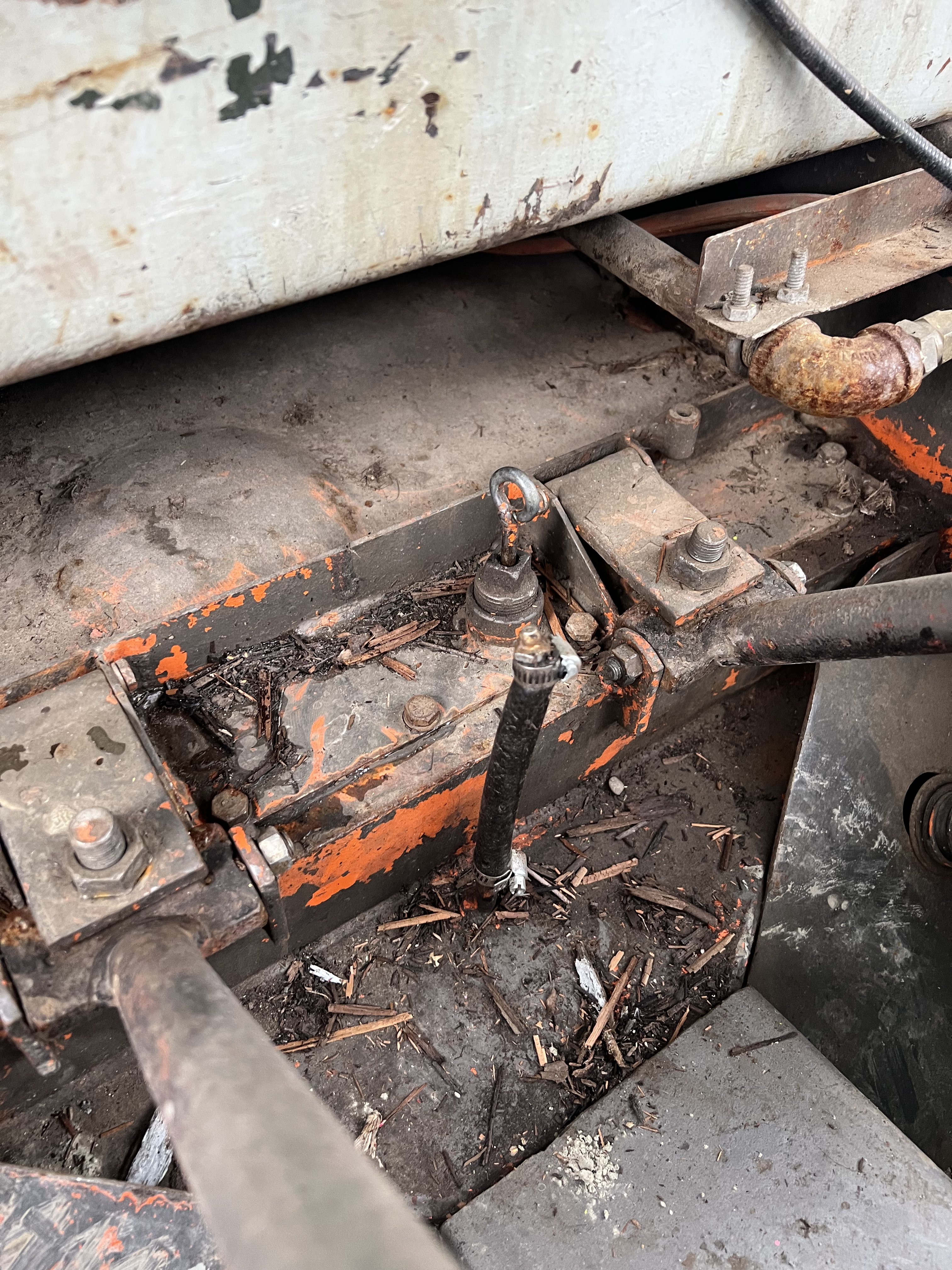

Just picked up this new little toy to do some mining this winter… I’m having a hard time tracking down a service/parts manual for it… the date of manuf, appears to be in the 80’s. It has a ford 400 with ap/r/n/d transmission in it.. this will be my first winter up here with this track rig so I’m looking for some tips to do a little pre winter work before the snow flies.
A friend is trying to explain to me that I need to drain the front diff or to check for water, I cannot seem to find anywhere underneath this beast for a drain plug. (Is that what is pictured with the inside cab photo?)
also to get access to what I’m being told are bands that’s control the turning, I’m assuming I need to take the fuel tank off to get access to them??

Looks like a Muskeg tractor made by Bombardier. The engine isn't original. The machine is older than 1970. Those flat straps outside the tracks were the early version. Later, they had round bars.
Yes, you need t remove the front cover to access the brake bands. Drain might be on the side of the case by the drive axle.
