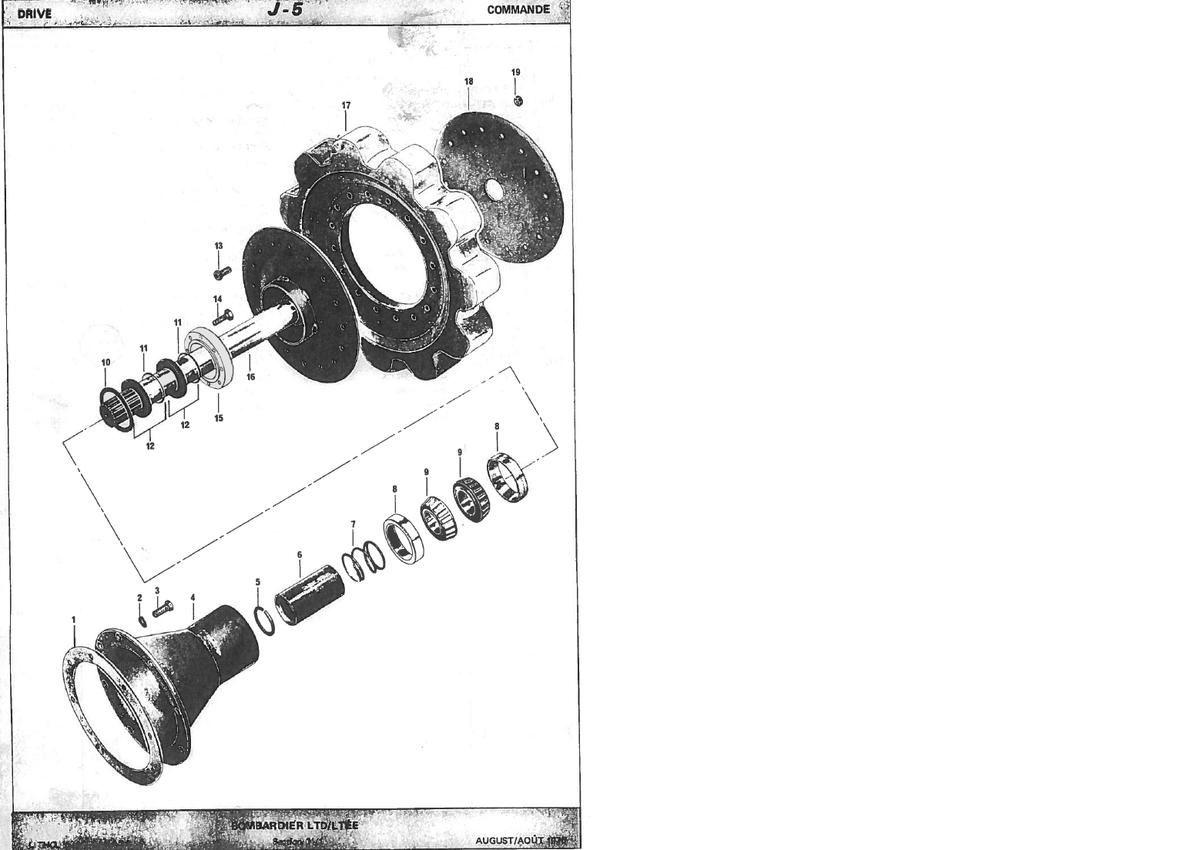

As you can hopefully see the drive sprocket has come apart....no its not the axle.
Is this two piece? Can it be welded?

buy the polyethylene (I think) sprockets from Minnesota outdoors. They are durable, light and cheap.
My bad i was confused. Here is the document that shows the assembly. Minnesota outdoors has allot of parts and i believe the piece you says is broken is cast.
