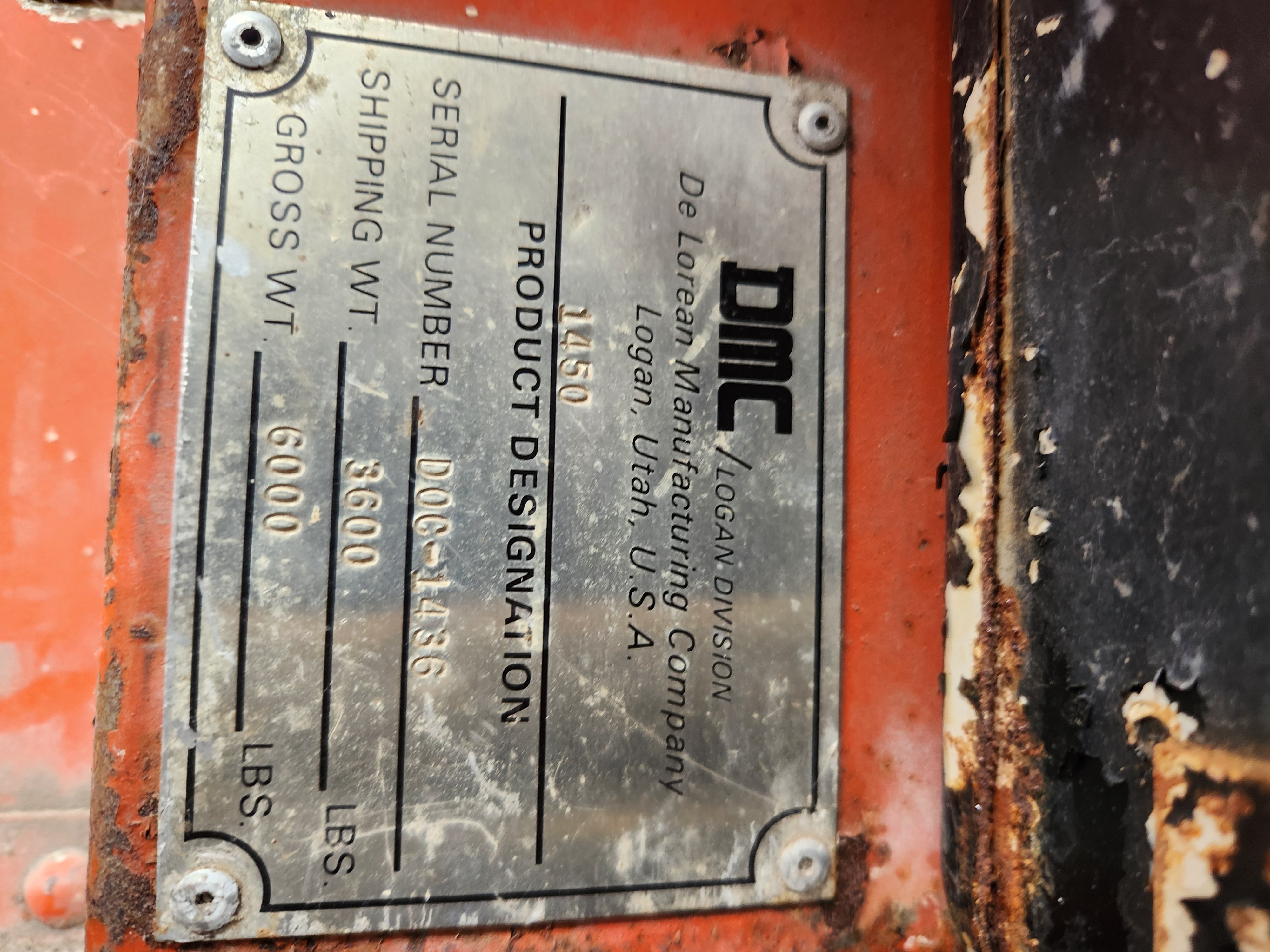

Sorry, I'm 55 and not tech savvy. Tried to load pictures, but having troubles.
Sorry, I'm 55 and not tech savvy. Tried to load pictures, but having troubles. View attachment 172355View attachment 172356View attachment 172358

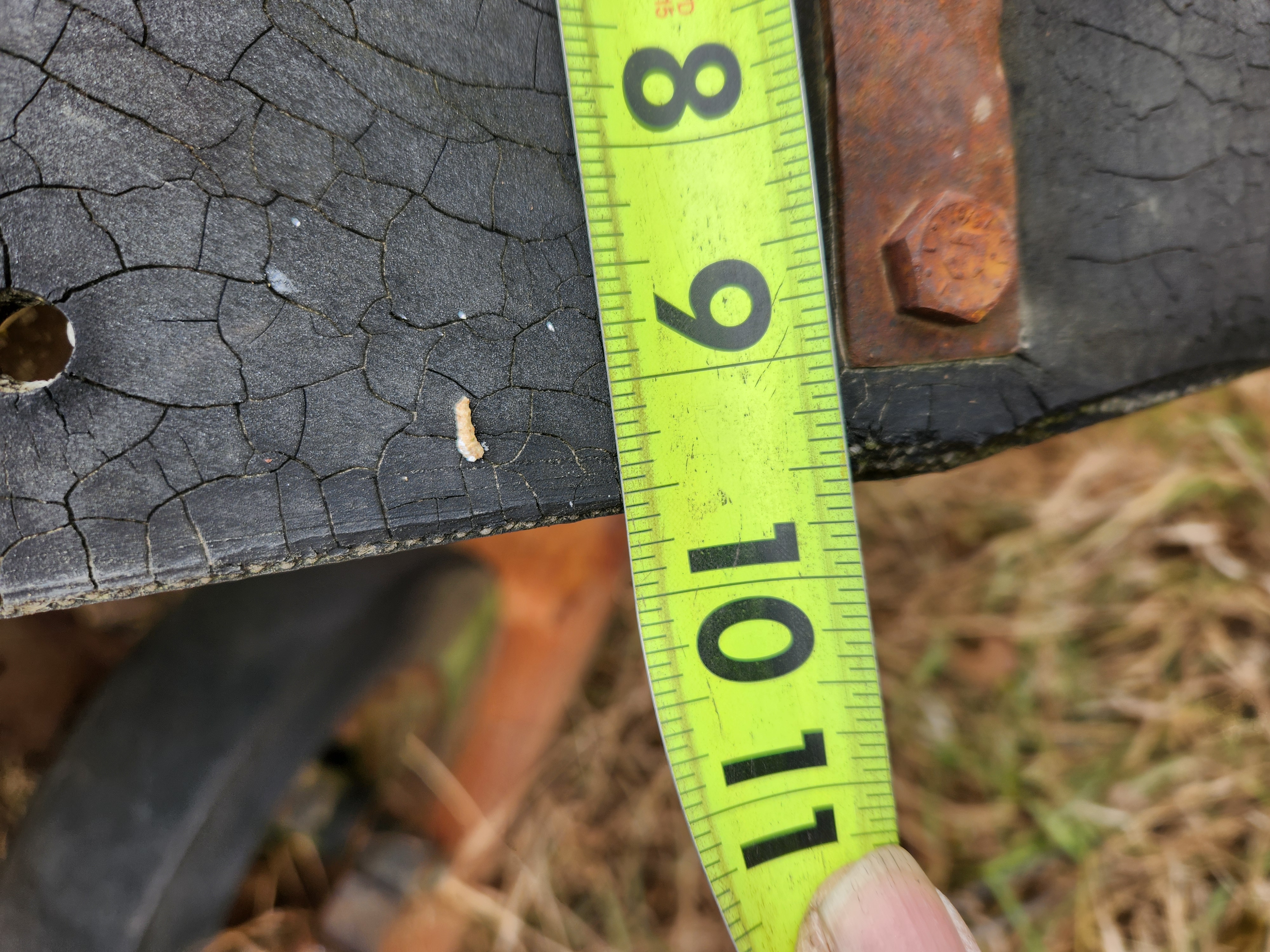

Based on the data plate I believe that is a 1980 model. I think the wide track versions used belts that are 9 1/2" wide, so it looks like that is a 1980 Wide track 1450. The factory blade would increase the value.

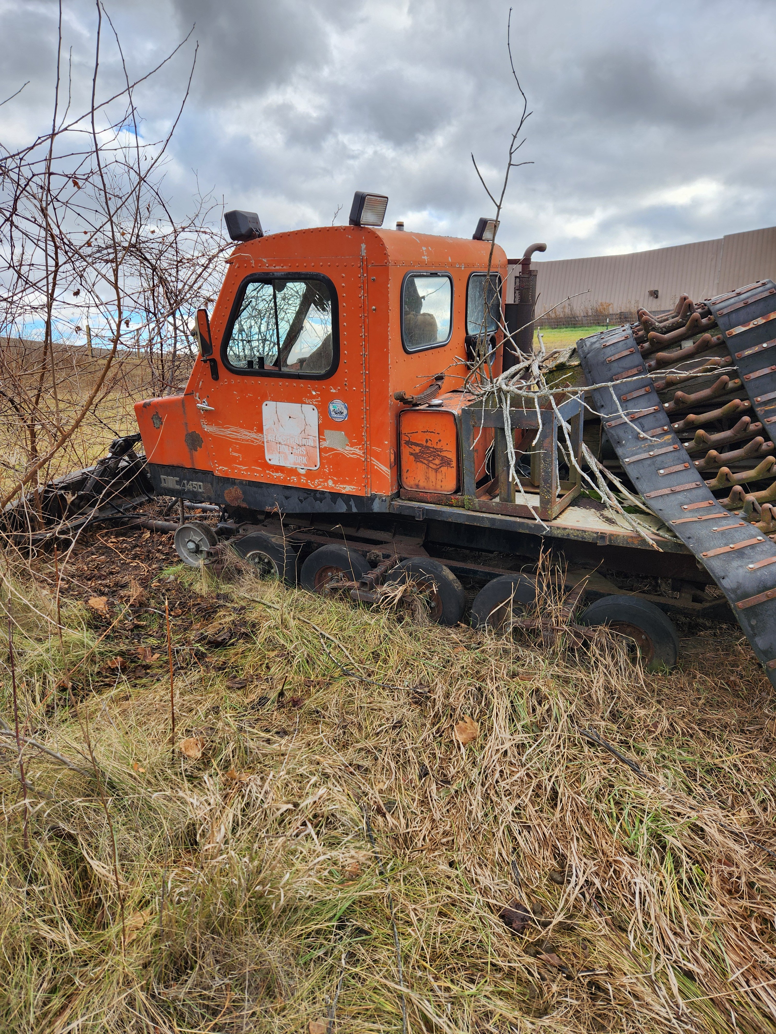

Without being disrespectful, to decide if it's economically viable to get it in operating condition, one would need to know what the acquisition cost is. If (big IF) you can get it cheap enough, it may be worth it. But if you value your time highly, that is less likely. And without personally inspecting it, or knowing how far you want to go (marginally operational or full restoration) it's impossible to say.

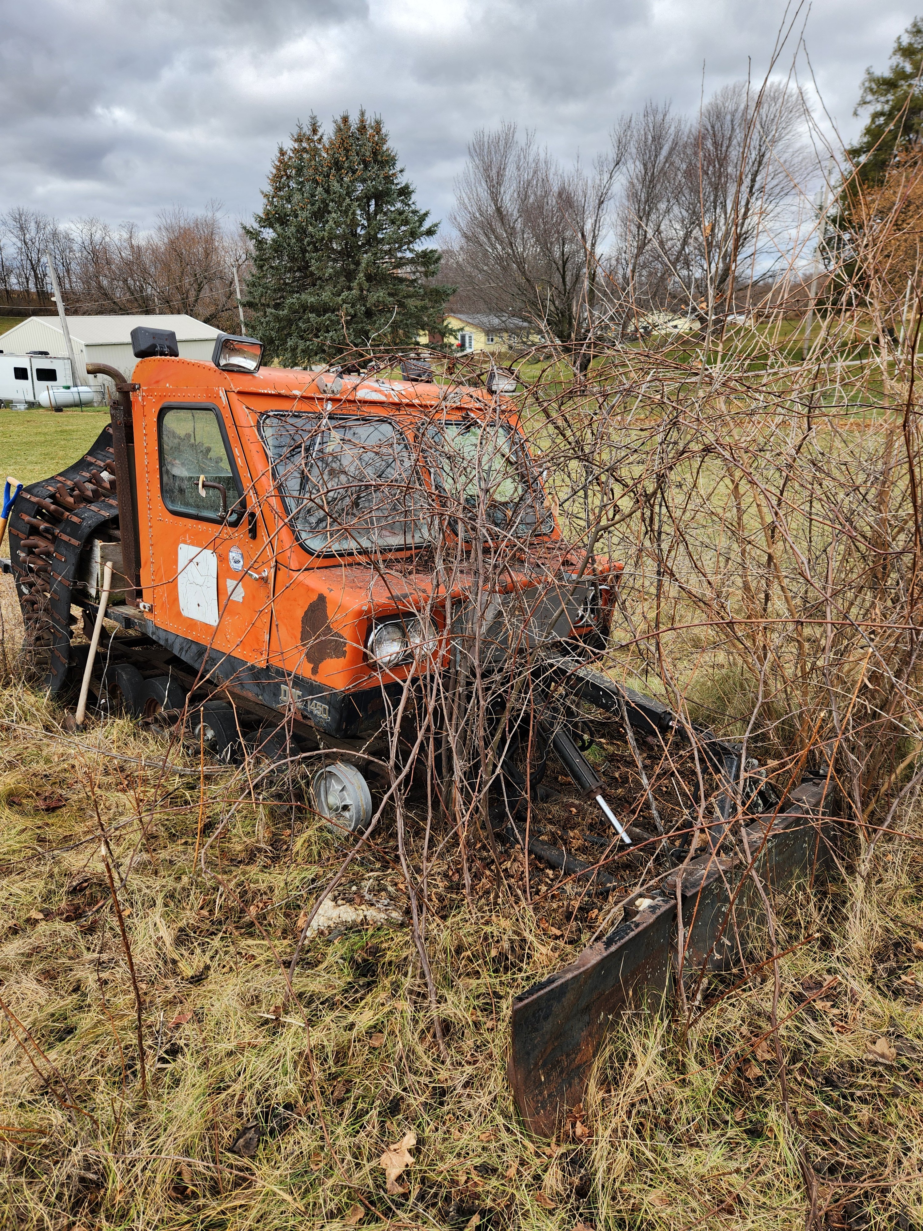

It looks like both front idler wheels will need to be recovered or replaced. If the latter, they run about $500, each. The tracks are draped over the drive sprockets, so they aren't visible. If they're bad, figure about $600, each to have them recovered. What shape are the tires in?
The close-up of the track belting shows it to be pretty weather cracked. If the pic is representative of the track belts, I'd plan on new belts. You can buy them pre-punched, or you can buy the raw belting and punch the belts yourself at considerable savings, but either way, installing new belting is a chore that no one describes as fun.
A 1450 Super Imp has a Ford 200 CID I-6 engine and a Ford C4 three speed automatic, as well as an OC-12 rear differential. What shape are those in? OC-12s can be expensive to rebuild.
There are too many unknowns at this point. Clearly, it looks like someone parked this and abandoned it. That's not a good sign.

Alternatively, you have two complete set of grousers and backing plates, and assuming they're in decent shape, they have some value. The blade system also has value, and assuming everything is there (blade itself, hydraulic cylinders, hydraulic hoses, control valve, hydraulic pump and assorted brackets, pulleys, mounting frames, hardware, etc) that makes for a very attractive package for someone wanting a factory blade setup to retrofit on another machine.
There was no such thing as a factory four-door Imp/Super Imp. One either got a two-door cab or a full cab, though some versions had the fully enclosed cab as open from one end to the other, and others had the setup as essentially two different cabs. Generally speaking, full cab machines bring more money that two door versions.
