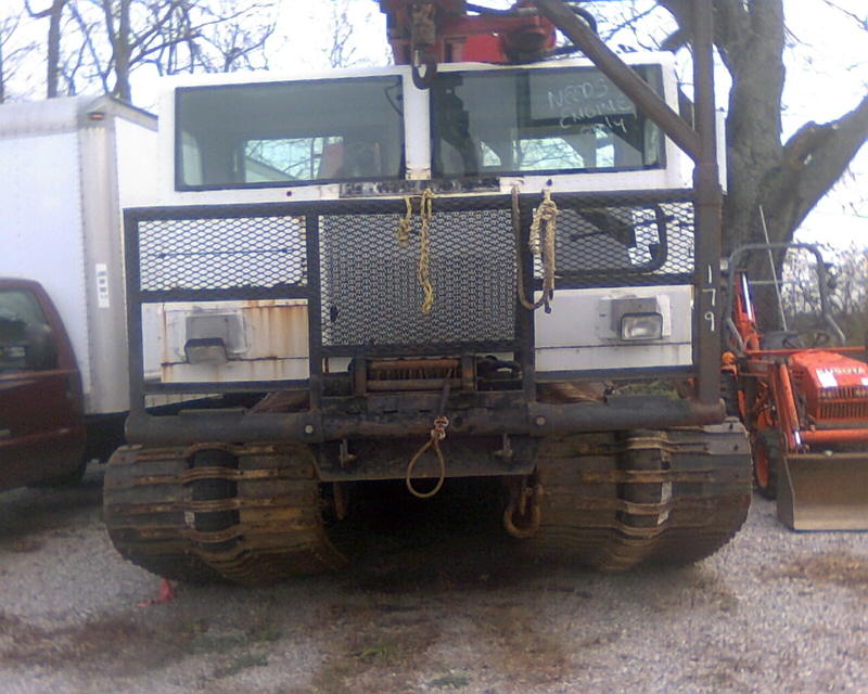

Hello everyone and merry christmas! I'm the proud new owner of a FN 110 Nodwell Flextrac. Not technically a snow cat but certainly in the same family. I bought the machine yesterday for a bargain basement price at an auction. It needs an engine. The 4-53 Detroit has the head removed. I'm wondering if the 453 is a standard, run of the mill configuration, If so I've located a good takeout for $400. What do you guys think about it? Are there any other forums out there that I should know about?

Looks good, the 453 was prob. a standard engine for that year model or what was installed per a bid request when it was bought (some cases owners could request certain engines). I had one with a cat engine in it, but if you can get a replacement, they were good engines, just loud!
Like the crane, would be good for hanging results from a good hunt on...
If you got it at a good price, then you did really good! Could prob. sell the crane separately for what you paid for the machine!

Well the Detroits can be made to run in either direction since they are two stoke, but I really doubt that you have one that turns other than right handed. Left turning ones are mostly in Marine Applications on older boats with two engines, but newer models us the transmissions to get counter rotating shafts.
Basically by the looks of it, you have a very standard Nodwell, with the exception of the crane. Not a huge after market for them (Nodwell 110), unless you pulled the crane off and put a tank on the back for fire fighting, there may be a good market in leasing for fire fighting. Which is what I leased mine out for. Most Utilities and such buy them new on special order.
