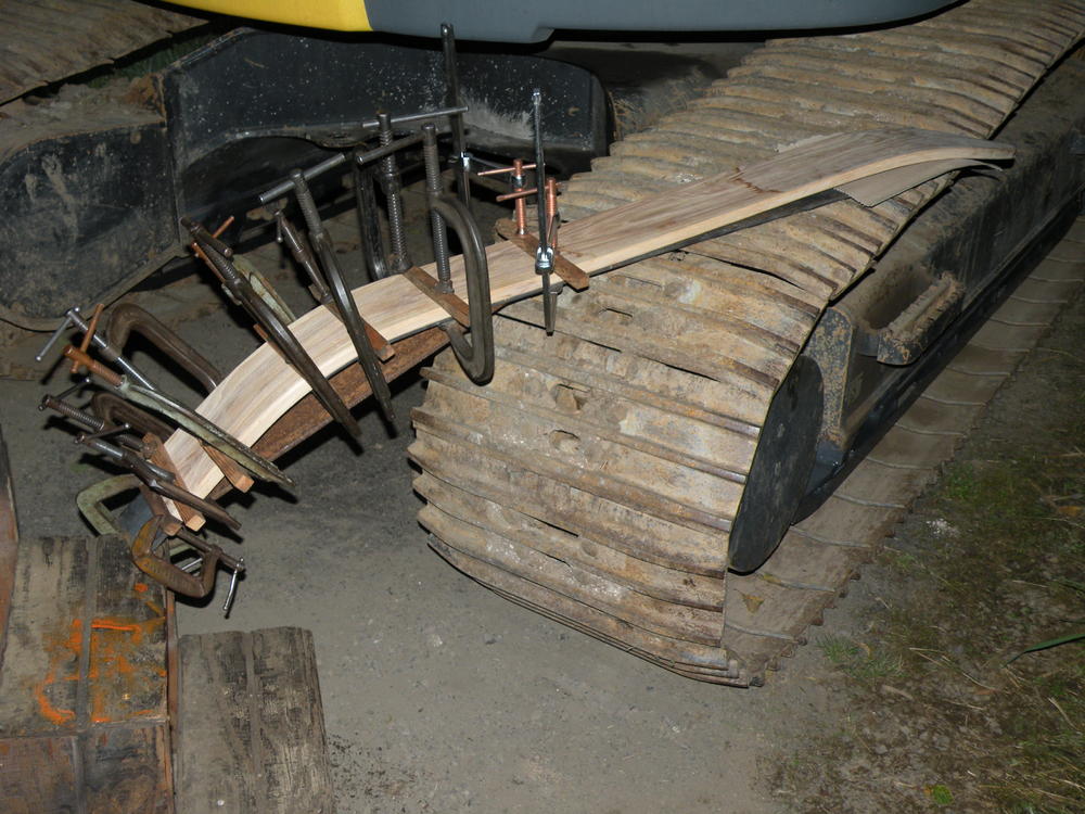

Here is how I steam bent the hickory skis. Steamed the tips for 45 mins. each and clamped them. The problem was that the wood I used had been kiln dried and it did not work as well as non-kiln dried wood, but it did not splinter.

Green wood be the best way to go. Also, I wood not hesitate to use oak, I won't tell. You may have to experiment with the steam time. It should bend without too much force. Wood turns kind of spongy. I let the ski stay on the steel forum for a day after bending. Don't know if necessary or not. I will ask someone who made them for Tucker back in the day.
For now im going to make the skis out of a wood,steel combination like the ones on the Glidden machine only because it will be quicker in my "outside" shop!!:biggrin: Next summer i will try bending some up out of "green" oak ,i have some nice Oak growing over by my sawmill. I also have a few nice Ash over there??:biggrin: The idea of getting skis laid up out of fiberglass went thru my mind,then when i found out it would cost $3400 for a mold and 4 skis it went out of my mind damned fast !!!!:wow::wow:Jinn,I have not found any s/n stamped any where on this trailer, but i will be checking hard on the drawbar tongue before i scrap it.
