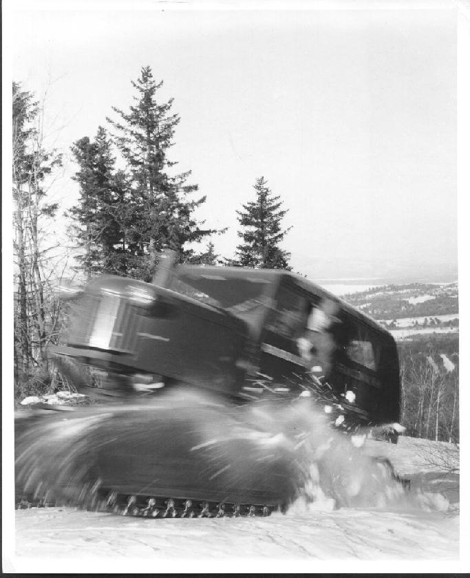

This pic is on echo lake Franconia.
Could it be?
I have that original picture, and as much as i would like to believe it was the same one, i dont think it is. The windshield is a bit different, and the one in the cover doesn't have axle nut covers.The one i got has cast iron covers with a grease fitting for the outboard bearing.It also appears to have a chevrolet truck steering wheel and gauges. :biggrin: I am a Chevy fan also !!!
I'm thinking the gauges are 40's Dodge truck http://www.bing.com/images/search?q...gauges&qpvt=1946+dodge+truck+gauges&FORM=IGRE
And your windshield has definitely been modified after the fact to accommodate the roof.
From everything I have found online, Cranmore early on only ran the 443's. So it probably didn't make the move from there. So, there could still be the outside chance it came over from Cannon & had the caps added afterwards to make greasing easier and cleaner??
Scott, The gauges do look like the ones in the second picture,guess dodge truck ,with chevy wheel. the roof just sits on the top of the windshield but the windshield has definitely been pushed forward on the top,probably from snow sitting on it,it has been out in the weather for years.
fyi, the gauges are from dodge truck late 30's to early 40's, have several machines with this gauges sets in them
I have been examining the "ECHO LAKE" photo and believe that my machine and the the one in the photo are probably the same one,with later modifications.On my machine the steering pulleys have been moved to the front of the radiator ,they are mounted on a piece of flatstock.if you look at the picture you can see the stud behind the radiator that the pulley should mounted on.There is also a layer of red paint under this last coat of orange ,and i was told at one time Cannon painted there stuff red for a few years.
