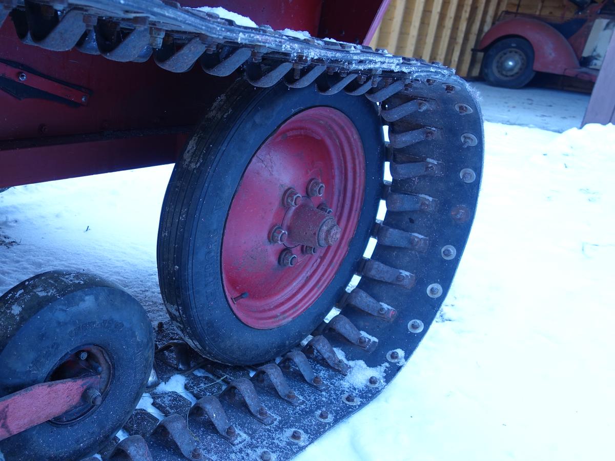

I plan to ask a "Custom wheel company" to make new steel wheels for the Snow Trac. Not a direct copy, but something with the same dimentions so they will fit like originals. Both in 5-bolt and 6-bolt versions. Since there are more "custom car" companies over at your side of the pond than here in Norway, I will ask a US company. Then you could - if interested - buy directly from them.
I am emailing a few companies now. Just to have a aproximate number of how many to make, are there any of you who might need new wheels? Not sure of the price yet, but I see that normally plain steel wheels (custom) range from around $50-200.-

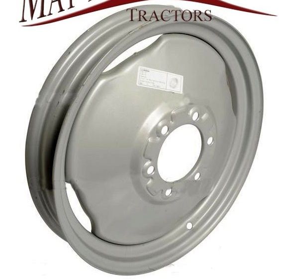

Tractor Front ( Wheel) Rim.
Nikos

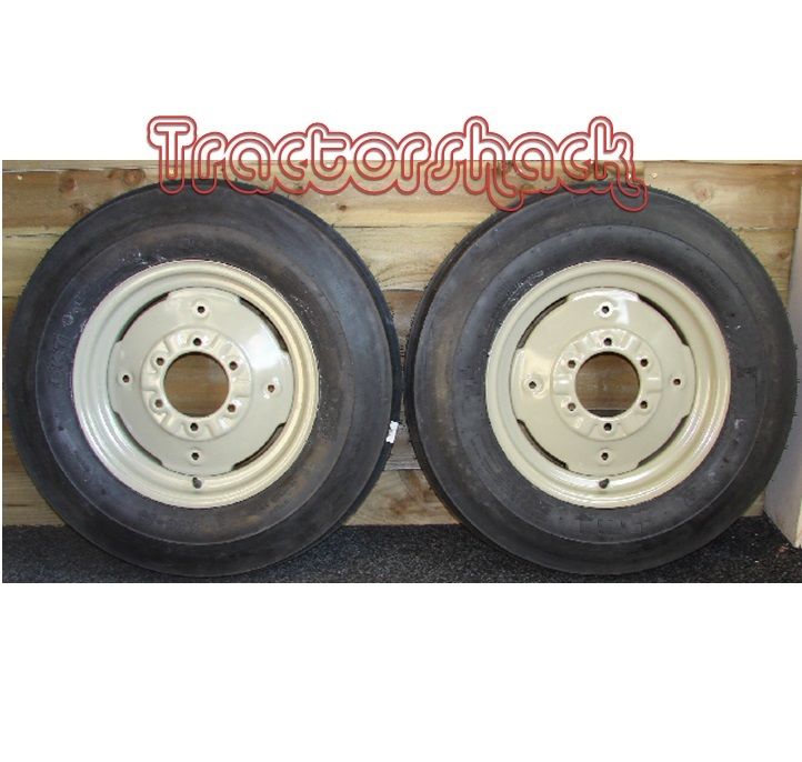

More details from another tractor front rim.
I think this type of Rim is from Ferguson T20. Is bigger than the original rim.
I will ask my dealer about the possibilities to find the right sizes of the rim ok.
Nikos
