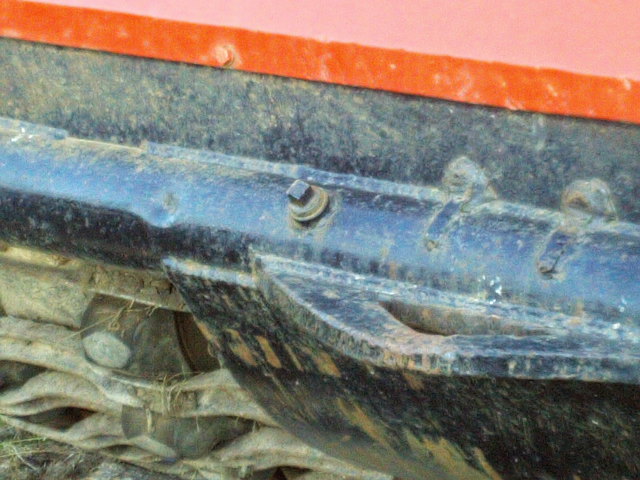

A couple of people working on these old Muskegs I guess. Here are some shots of our work thus far.

how does the suspension work behind the front spring? I see that its all chain supported but the middle tube, does it have a piston loaded inside or what? Also, how is it for dry snow, we get upto 4 feet in a year.

There is a heavy spring in the "middle tube". It keeps the walking beams from over extending. It's not used in the more modern versions that have two solid walking beams.
