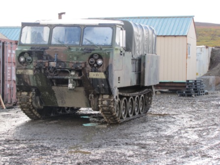

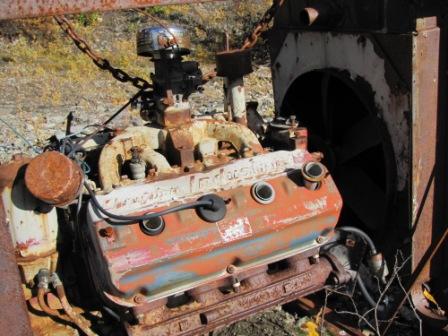

some pics of field repairs on the snow trac check out all that water and mud that is normaly a good dry hard stand to work on also some pics taken from a mining camp loook at the condition of those snow trac sprokets and pop quiz who can identify the armord car pictured

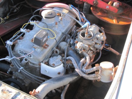

some more pics in the last post i thaught the hemmi would make a good motor for benz-9's sw 48 or pixi's muskeg the rest of the pics shoew the flood this the trail to the river normaly dry
The "armored" rig is an Alvis Stalwart.

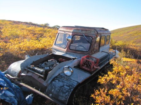

i had a spare set of worn but servicable sprokets in town so i ran in and got them before the rain when the axle stripped i tried to weld then several times and got a spare axle dropped off at the truck and and used the spare hub with that the old sprokets were on the broken rear hub aka rock damage was a quick repair with some nickle rod just a 2 mile walk with parts in the ruck didn't even have to break track. didn't get a moose just too darnd wet and warm temps were a steady 55 to 60 degrees day and night we also took the 578 and tried to get in to tellagraph creek tha back way and got the tank high cenetered between the front and back my 11 year old got to learn the power of a #2 spade when we shoveled it out so we didn't have to walk weather was the worst i've seen

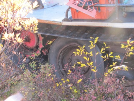

Who's Toyota powered Snow Trac? Just sitting out there uncovered? Wow what you guys can find up there.... Another "big wheel" model with the two band track....Seems to some what common now that I am seeing some machines. Does it have an owner?
Regards, Kirk
that is not a big wheel model it's had the front boggies cut out and a vw front axle grafted in to it it's an assed up way yto do it an they are weak and won't stay in the tracks. mine broke the ball joints just pulling it up on a trailer when i got it. stand by if and when i get it i might try some thing different with a torsion spring axle like a thiokol.
