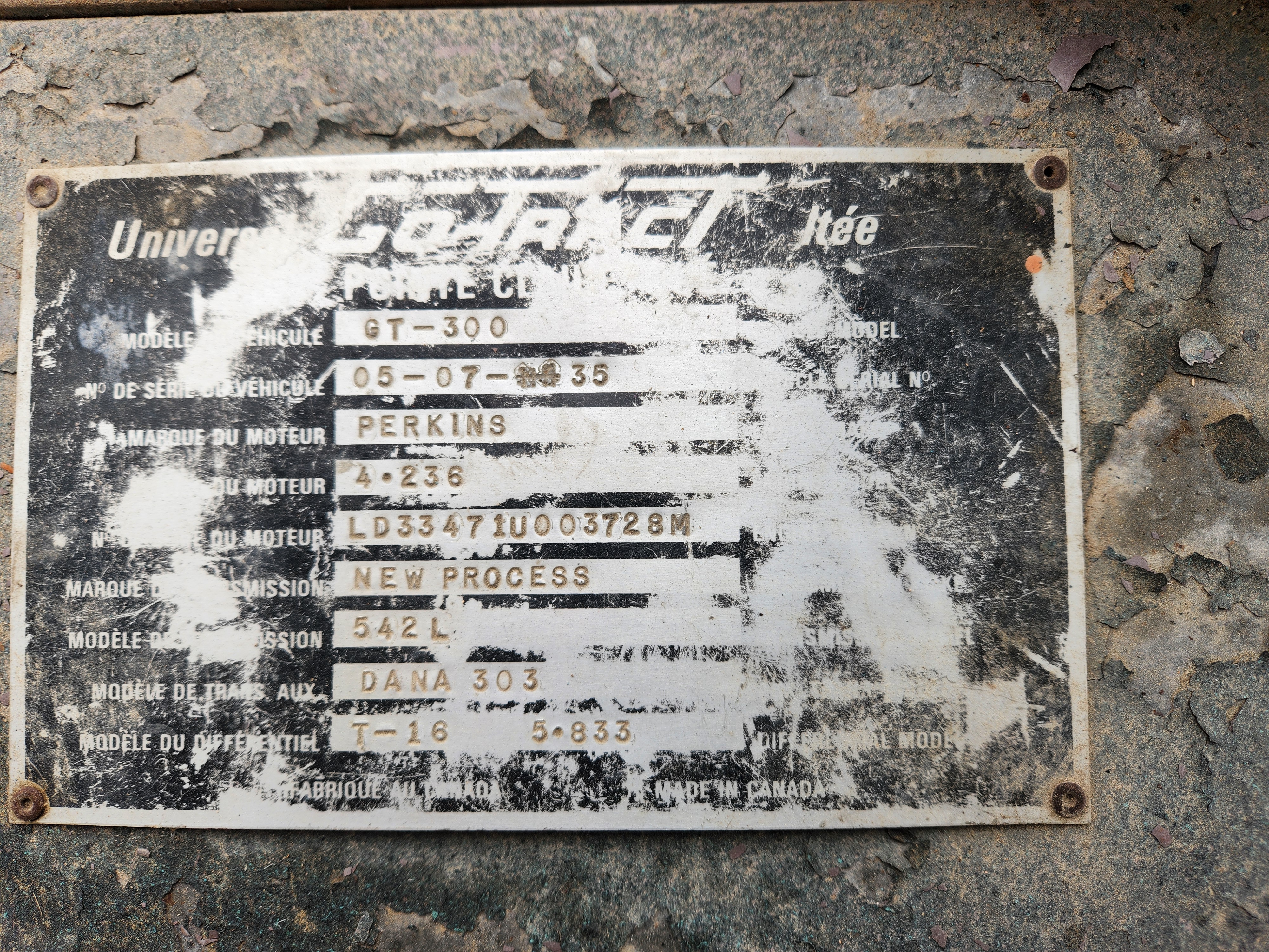

I am on the verge of pulling the trigger on a mid 80's Prinoth GT-300. I know NOTHING about snowcats, but I have test drove this and it seems to run good and function as it should. I am looking for any info I can find on it as so far my internet searching skills have made zero headway on learning about this machine. It has a 4 cylinder Perkins diesel in it. The data plate calls it a 236...I think; it's all in French. It has a New Process 542L transmission, I believe a Dana 303 axle, and a T-16 2-speed T-case. Again, it's all in French so I'm not 100% on all of this. The size of the machine is about 7.5 feet wide by 14 feet long. I estimate it to weigh somewhere in the 5000 - 6000 pound range.

If you run that eng serial number it's an LD (4.236) , U (built in UK) , M ( year of manufacture) either 1985 or 2005 as the letter M is used again. The serial number of the vehicle is 05-07-35 , you would think it's the 35th built in may of 2007 or July of 2005 , if the motor was built early 2005 in Britain or it's been replaced. Have you got paperwork showing this machine was made in the eighties ? Looks like you'd have to register on the Prinoth site to possibly get any info.

It very well could be that the motor was replaced, although the clock only shows 1600 hrs. It really doesn't feel '05 or '07 ish. Is sure feels 1985. Very little electronics involved; mechanical injector pump, no glow plugs, and is somewhat underpowered. I took it out for the first time yesterday. I've got pretty major oil leak. It is the strangest thing, too. It seems to be leaking gear oil from what looks to me to be a hydraulic line that attaches in what I would call the yoke in front of the rear differential, just behind the parking brake. There are 2 of these hoses that attach here and I cannot for the life of me figure out what they do or where the other end runs to. It seems to disappear under the transmission somewhere. There is zero access under this area. I think I would have to pull the cab off to see anything under there.

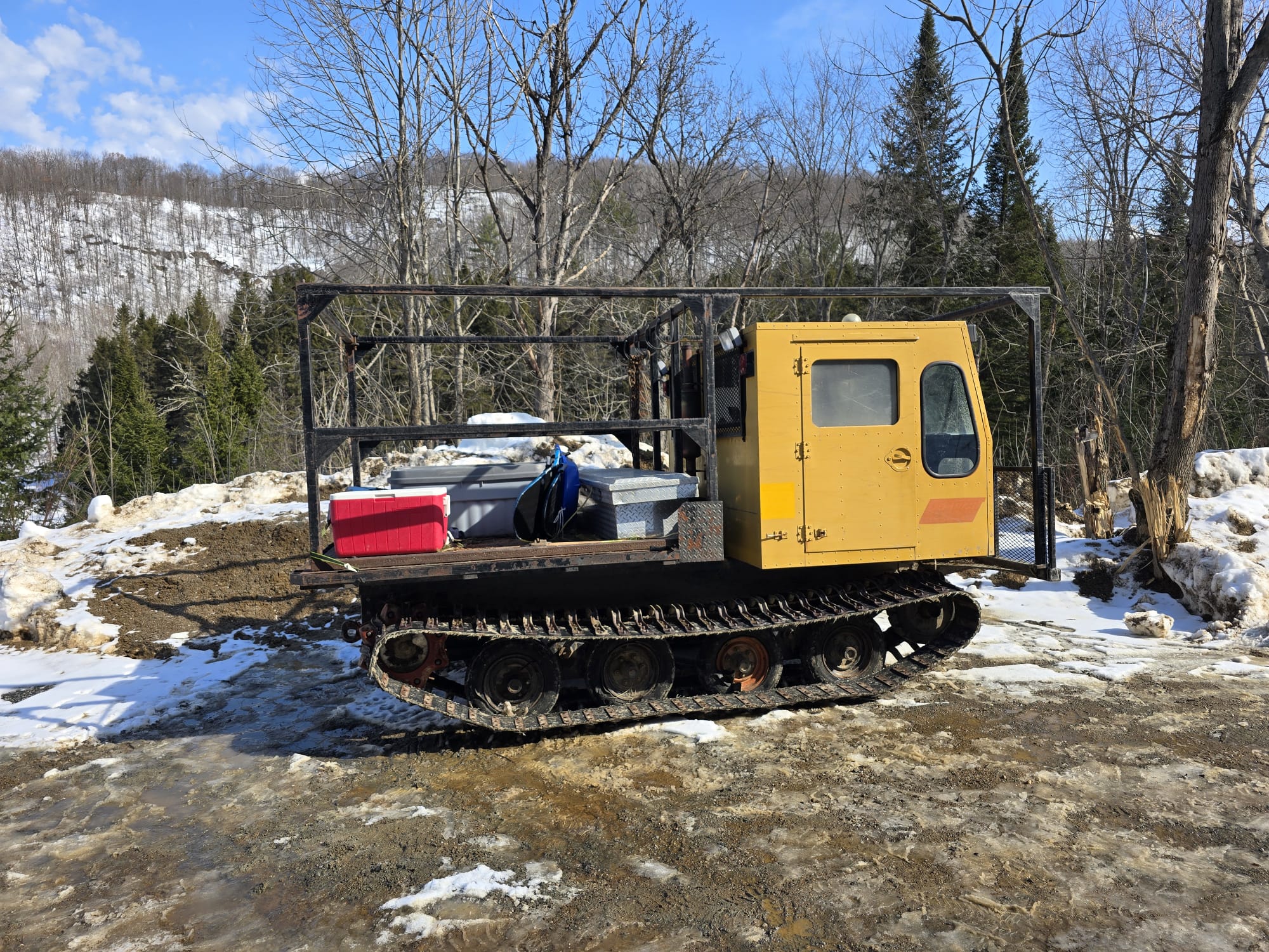

you likely have a go-tract, I have a customer who has one and it looks like yours. They are heavy
Yes, it is a Prinoth Go-Tract 300. This is a fairly heavy machine. I estimate between 5-6000 lbs. All of the running gear is heavy duty like it was built for work. Do you know anything about your customer's machine?
Yes he rolls his rear idlers off the rim a lot cause he can turn so tight, and he does a lot. They are more utility cat than snow cat. he loves his, he grooms trails in the mountains of western PA
