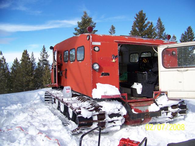

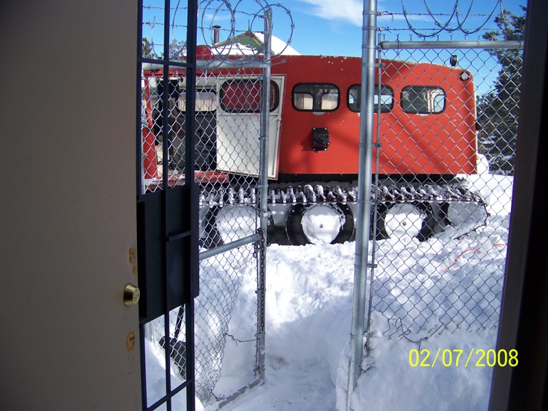

Thanks. I haven't got the checklist done yet, but did use the snowcat on a 30 mile round trip to a communications site here in New Mexico. Here are some pics.

Nice 601! I love seeing other owners enjoying!!! Looks like you take nice care of her too. 8)
