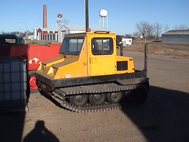

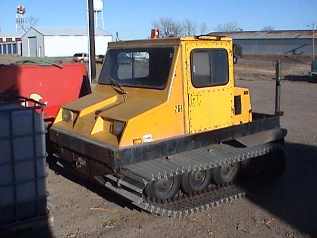

I finished up on my Bombi. I drained 1.5 gallons of water out of the differential. Probably why it wouldn't move when it got cold. I was lucky it didn't crack anything. I replaced all the fluids and fixed the heater. Should be good to go now. Thanks for all the help.
Now you know why they say to park your Bombi 'nose-up'. :pat: It keeps the water from collecting and leaking in through the pinion bearing.

Well, I just got it last summer and didn't really do anything with it till now. I'm the only person I know personally with a snowcat and I think the people who worked on it last figured if it couldn't be done with a pliers, then it couldn't be done. I had never heard about facing it nose up, but will from now on.:thumb:
