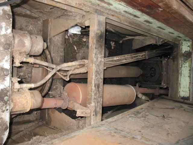

I am looking to replace, at least the right side slave cylinder. (maybe both)
And also the master cylinders.
On my Model 601 Thiokol Rangemaster Serial # 194.
Having a real hard time making right hand turns.
It can be done by gunning the motor, and using every bit of my 250 lbs!
(even the grandkids, were wondering why we kept making left hand turns...) LOL
Neither parts shows any leakage, nor are low on fluid.

Hopefully, this picture comes through this time.
Take care, be safe.
God Bless.
Chris - Alaska

chris , I would check the brake band itself , or that the slave is not throwing as far. It sounds like a problem I had once . It wound up being the brake band broke where the pin pulls on it and spread , slowly lost the steering. Just an idea. :unsure:

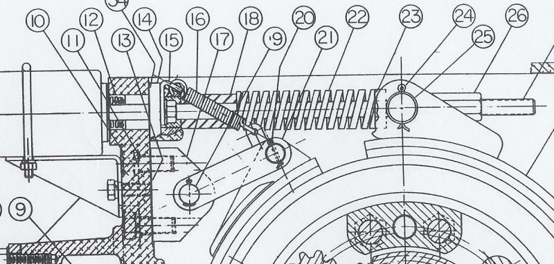

yes , most, if not all, do. Yours are just under the cover . The adjuster nut should be closest to you , if you are looking at it from the back, and there will be a spring right in front of it. # 26. Hope this helps.
While you're in there you may as well look at the brake band material to see how much is left... You can buy replacement material around but Boggie has this special home-brew stuff he had made for his world of cats. *However*, I think the authorities won't let it cross state lines given it's toxicity. :wink:
