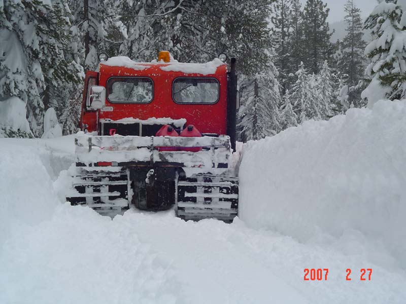

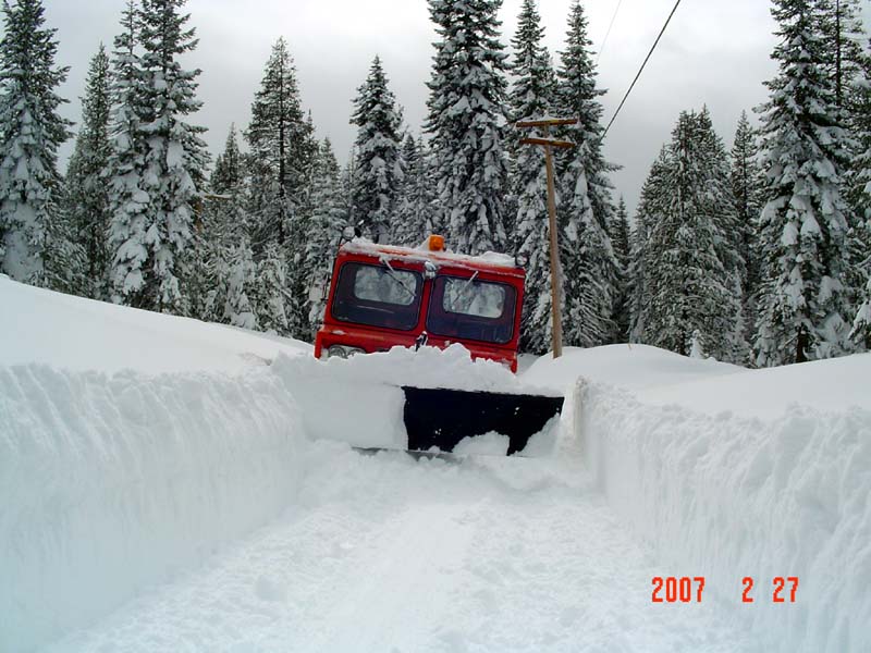

Pics as promised. Notice that the snow is above the floorboards. BTW, the plow blade was all the way up and was still pushing snow. This 2-mile downhill (700') trek took forever in 1st and 2nd gears. Uphill would have been a no-go. IF you are dealing with DEEP snow, I'd consider something different.
:my2cents:

I see you have the standard small width tracks. The Super Imp I was driving had or has the wide tracks. It actually did pretty decent in some powder we were in up in Lomoile canyon NV. I know you can even put on some wider tracs if you want. I believe his tracks are 31" width and can go up to 36 relativley easily. I have even seen some for sale for $400 bucks for a set in decent condition which is a steal! Anway nice pictures. Have anymore?

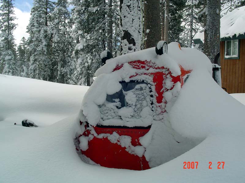

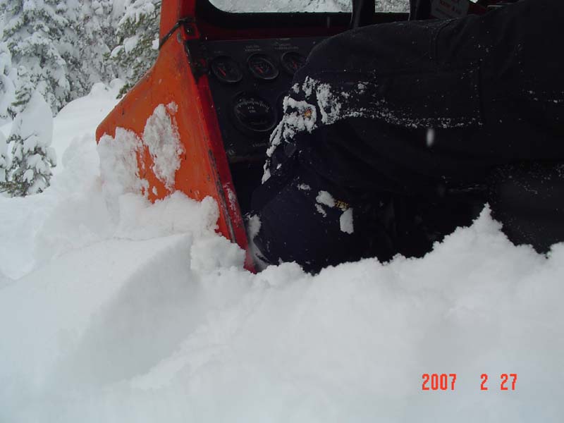

Correct....25.5" track width on the Super Imp. So you are looking at a PSI imrovement of 18% or 29% with the wider tracks. A side benefit from the wider tracks is that you won't have as much snow spilling into the cabin as I often experience. Of course, one should not operate any cat with the doors open but the Imp's defroster leaves much to be desired (con). Also the small size of the cabin is a con for big people, but you already know that.
Attached some more pics from the same day. The frontal shots were taken by backing up and walking in front of the machine. Wider tracks would be sweet. :coolshade
