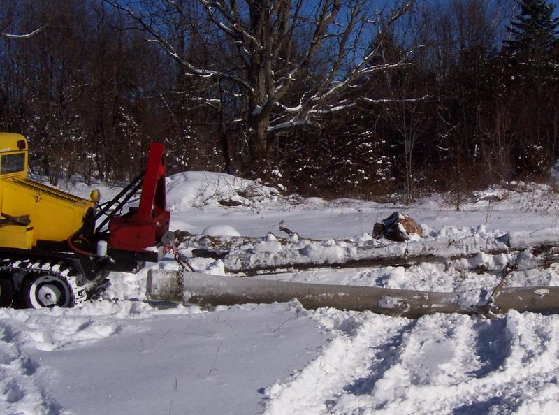

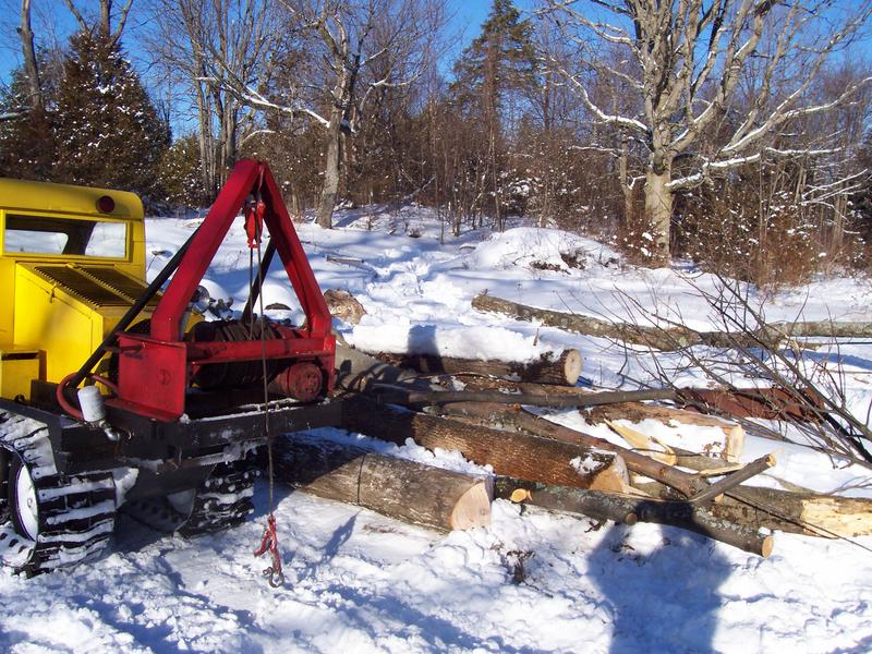

they will work for light logskidding.:17875:
1967 sw48-$1500
20,000# tulsa winch-$100
assorted hydraulics-$500
Buzzing thru the woods in the middle of winter in a HEATED cab-priceless
