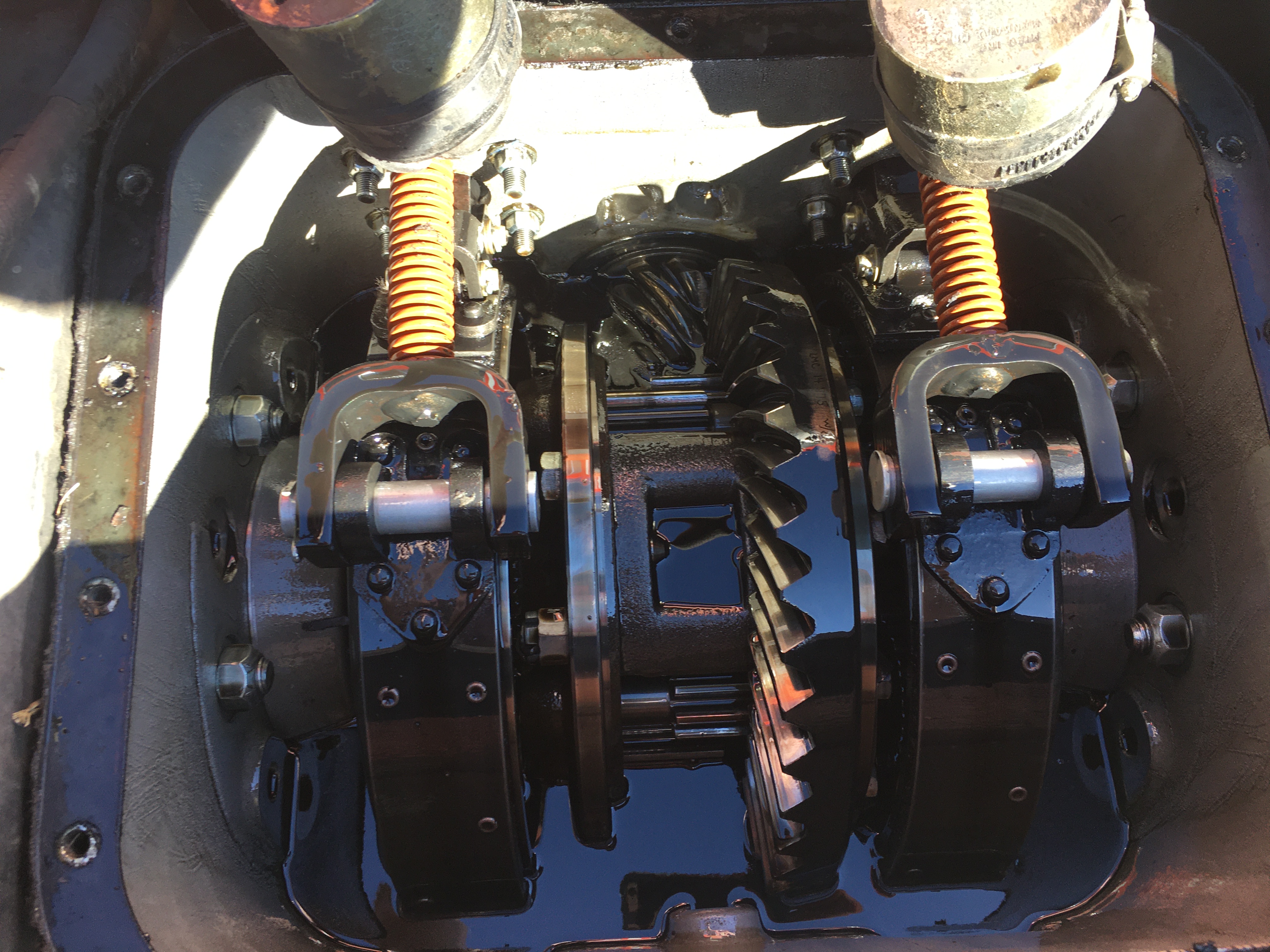

I drained and re-filled right up to the fill port, but I think I’ve also read that some folks add 1 gallon above it.Oil level looks good right up at the fill port.

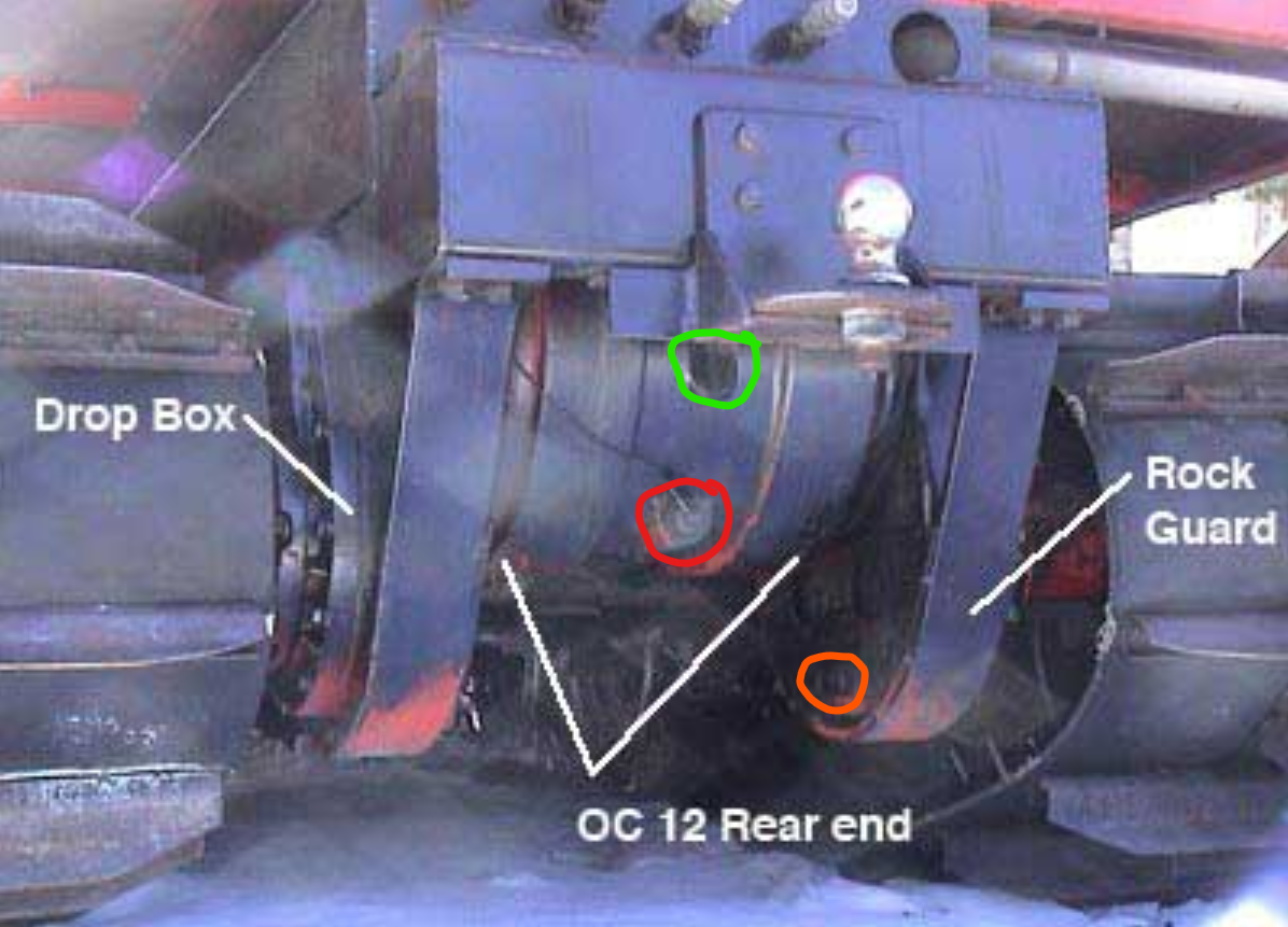

Of course you know were the drain plug is, just behind the ring gear in the photo, at the center of the case, in the rear, below the centerline of the chunk, (the internal planetary gears)Thanks all. I ordered some hy-gard low viscosity. I also heard good things about this: https://www.napaonline.com/en/p/NHF85401
Now I just need to figure out how to drain my fluid![]()
Yes, those ones.The threaded metal plugs?
