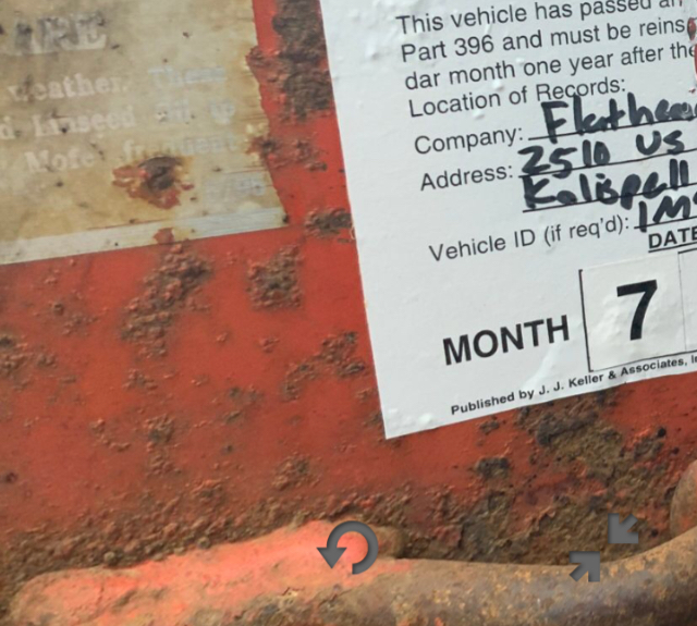

The trailer is up for sale too! The trailer does raise a few red flags....it appear the rear diff is leaking pretty bad..hopefully no water (or SALT water) got inside the diff!

I kinda agree with @tomelroy on the rust concern. If you look at the trailer that the cat sat on, it has significant surface rust. Salty road exposure? put away wet? stored next to a highway with mag chloride mist? Hard to know the true condition without a first hand inspection.
