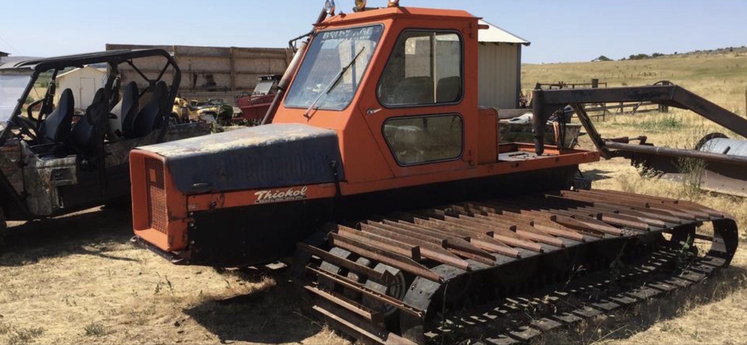

I have spoken to our local glass shop about a new windshield for our smaller 2100B. He says no problem since they offen do store fronts in laminated glass and can bring it for installation to my shop( when it gets a bit warmer).
The plastic can get you through the winter but will likely scratch and become useless quickly. When I service cats that need fresh glass I pop it out and make a template with cardboard or plywood/masonite and go drop the tmplate off at the glass shop and ”slide“ the glass back in till the fresh piece comes. If it is too broken then plastic comes into picture, but only as a placeholder. The wipers, cleaning, and environment just scratch plastic too quickly. Also if I recall correctly the glass is not much different than plastic.
