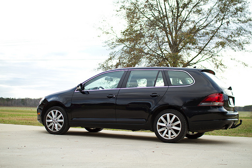

Thanks for the suggestions so far, I'm still searching around the net attempting to find a satisfactory solution I think would bring me both long term satisfaction and results. I found a good example of what I'm seeking on a VW forum, but it's a bit vague on exactly what springs he utilized to achieve the results. Picture below...
Here is the opening post from his thread...
I just got done installing a set of stock Tiguan springs. When I pulled them out of the box i was disappointed that for the rears they were the same height.
further looking i saw the tiggy springs were about twice the thickness, So i installed the tiggy springs any way. Then i installed the springs up front. By the way hopefully there is an easier way to take the coilovers out with out tearing the front suspension apart. When all is said and done my car is about double the height as it was with coil spacers in. he ride is just how i think the sportwagen should be! It takes corners way faster and smoother and doesnt feel like a heavy wobbly pig. The sportwagen is 400lbs lighter than the tiggy so the springs are not stiff and not bouncy. I also dont have that horrible understeer that i had before. It just hooks and goes! I needed a taller car but wanted the great handling of going lower so now i got it for under 110 bucks. Ill post after pics later. I didnt think to grab a before and during pics as this was a pain in the A$$ to do but well worth the blood and hard work.
Source
A bit higher with some obstacle clearance, and far better handling. Just what I'm attempting to achieve with ours. Now to see if the 2010 and 2011 Sportwagen models are comparable and exactly what Tigan springs he actually installed. Got a feeler out to one supplier at the moment but I have a feeling a few more feelers will be necessary before I find someone knowledgeable enough to direct me with the proper spring application I'm needing or looking for... :unsure:
