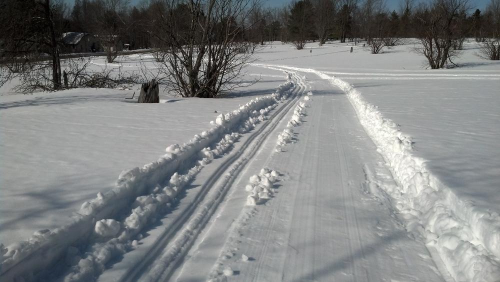

Here is a couple still pics, one of the groomed path that was laid down over approximately two feet of virgin snow with one track-setter down, and the other of the machine driving back after doing the grooming. It was a relatively warm day with temps in the mid-40s, the first day above freezing we have had this year so far. We have had over six feet of snow fall in that time period, which had settled down to a little over two feet of powder before the warm-up.

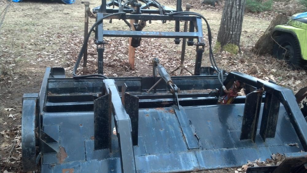

The tracksetters can be operated independently and can be in the raised position, lowered in a 'float' position, or lowered with hydraulic down pressure. Each tracksetter has guides on either side of the arm with holes drilled through them so a bolt can be put in place to set the limit of downward movement. The 1450 is equipped with 3 remote hydraulic circuits in the rear, one to raise and lower the groomer and one for each of the tracksetters.

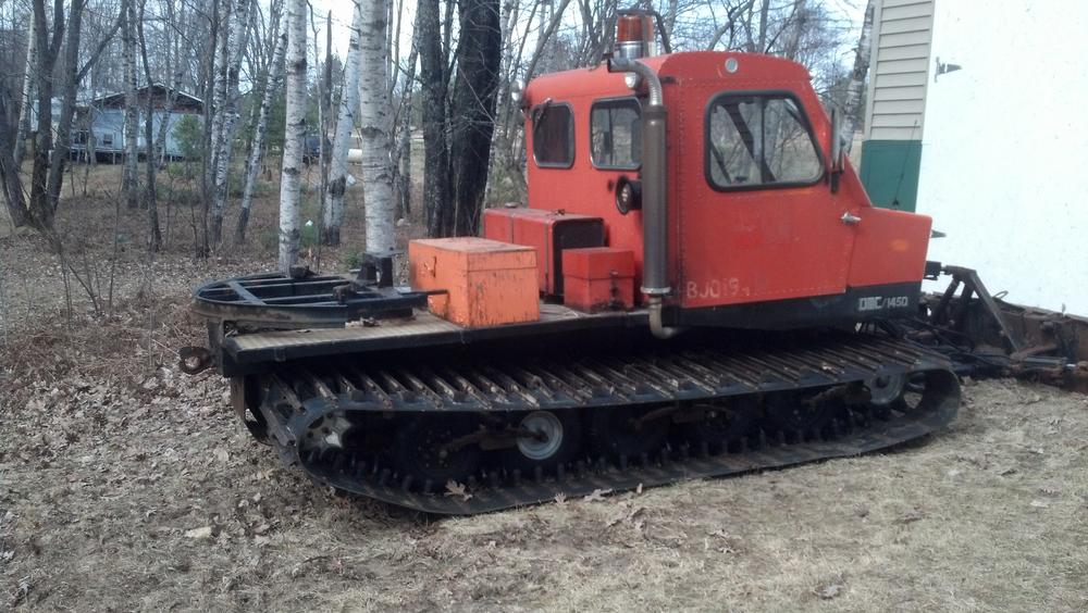

Took the groomer off yesterday to prepare for starting some maintenance. Thought a couple of people may be interested in a better look at what the groomer looks like. Was surprised to find out the hitch for the groomer is not only bolted, but also welded to the rear chassis. Guess it is not going to be so simple to remove as I had thought, but not a real big deal. Dropping the groomer off will make greasing the driveshaft and bleeding the steering brakes a whole bunch easier, not to mention checking the steering bands.
