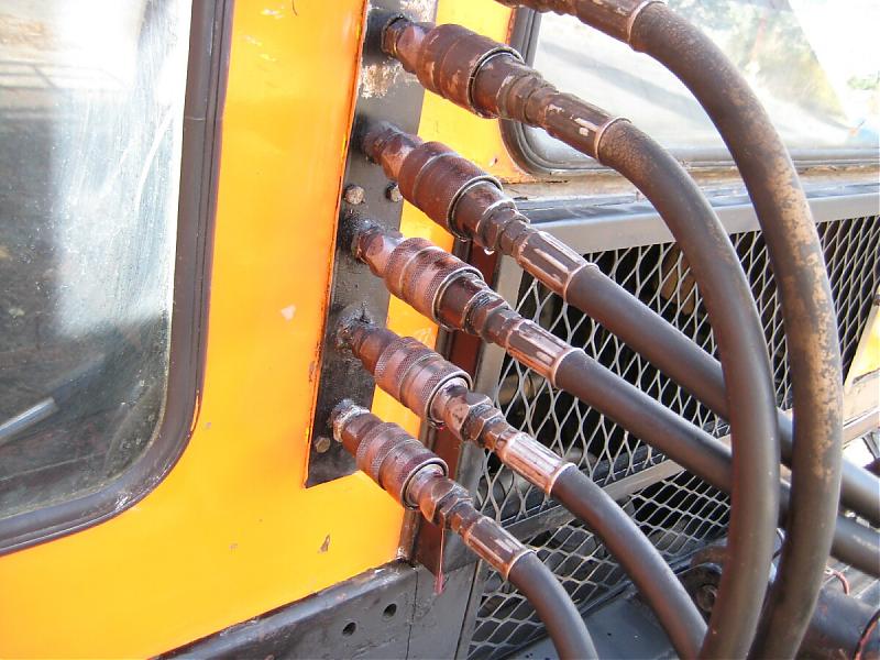

Leaky hydraulic fittings - replace hose or quick-release fitting?
kgracey
Hey there!
I bet many people can answer this one!
Look at the attached photo and you'll see that I've got some hydraulic leaks on the quick-release fittings.
What's the recommended solution? Replace the quick-release fitting or the hose? Northern Tool a good source?
Thanks!
Ken
Ken, 90% of the time it is just the O Ring inside the female end that will correct it. on your other problem if you do not need the roll just swap the hoses and use that function for your angle cylinders. :thumb:
Thanks Boggie. I'll consider that, too.
Got a recommended source for these o-rings?
I measure their O.D. to be 1 1/16". What is the actual size I'd order?
Thanks everybody.
Ken
Any autoparts sotre will have o-rings. I always carry a bunch of them with me in the cab. They blow quite frequently on the fittings for the drag in the back.
Problem solved! $0.50 and a trip to the hardware store works wonders, indeed. Thanks Brad and GroomerguyNWO. I'm miles ahead now.
