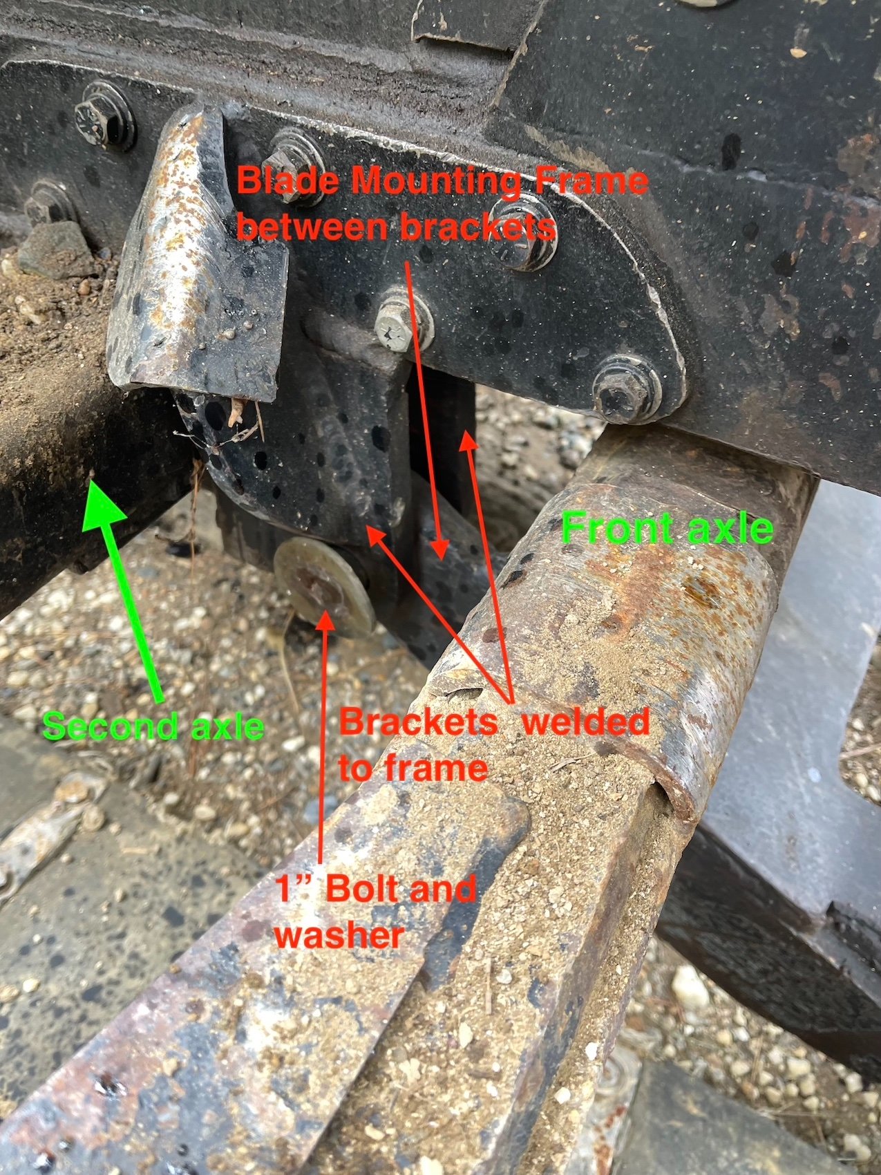

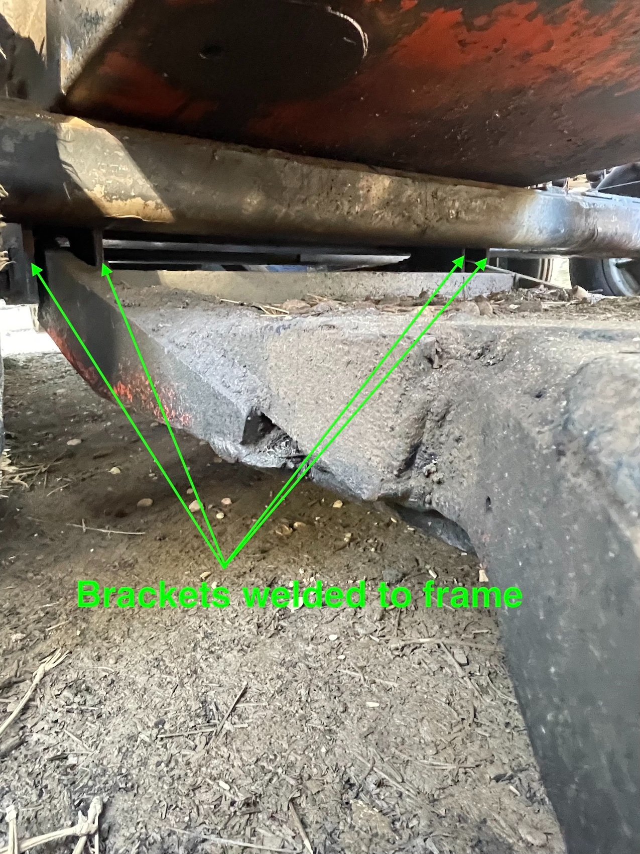

I don't have photos of the 2100, but I can get some when I go up to the camp. It is about 100 miles away from here. The 3700's have bolts on the bottom of the frame and brackets for the rams bolted to the sides of the tub near the front. Do you have any frame that came with the blade. Our 2100 has a 6-way blade up/down, tilt, and angle of cut. One of my 3700s has a 6-way blade that has up/down, angle (like a road grader), and angle of cut.
My frame probably hasn’t had a blade on it previously, as the Thiokol logo was right where those brackets mount. The upper control arms and the upper lift cylinder mount bracket came with the blade, but this blade looks to be only 4 ways, with up/down, and tilt, but not pitch (I think angle of cut) or yaw (forward and backward tilt). I’m adding on the pitch, and the hydraulics kit has blade tilt, but I think I’ll leave that off and use that last set of connections for the rope tow winch. From what I’ve read, the 3700s came with a blade, but the 2100b didn’t, so it has to be braced on the front axle. But finding pictures of that is not easy. Steve in McCall seems to have manuals for everything but the blades. Are your blades full track width at tilt or straight or somewhere in between?
I have a frame from one of my 3700s out in my yard. I could take a picture of it, if it would help.
I think the blade on the 2100 is full width and both blades on the 3700s are full width (12'3"). The 3700 with a 12-way blade is full width and it has asymmetrical tracks. I think they were around 54" wide. I think the frame of the 3700's blade mounting frame are the same width as the snowcat frame. There are two pieces of steel welded to the snowcat frame that drop below the frame. The frame for the blade fits between them. Like a shackle for a leaf spring. I can take pictures of one of them, because I have it at a friend's house not too far away. I can take a few pictures of the blade mounting frame bolted to the snowcat frame too. I think I have the blade off of that snowcat. I will be going up to where the 2100 is located this weekens, so I will take some pictures of it too.

So if your after a functioning collection of snowcats you need one for every situation. The restraint is needed to *just not acquire another cat with a blade* ironically i have a 2100 up at my camp that had/has a blade. Pretty sure they are bolt on pockets that nest around the front axle. It will be a few weeks before i go there but your welcome to the mounting system.

Here are the photos I took of our camp's 2100 blade mounting system. I hope they help you figure it out for your configuration.
Were these of any help? I am going back up there again next week if you need more photos or measurements.
