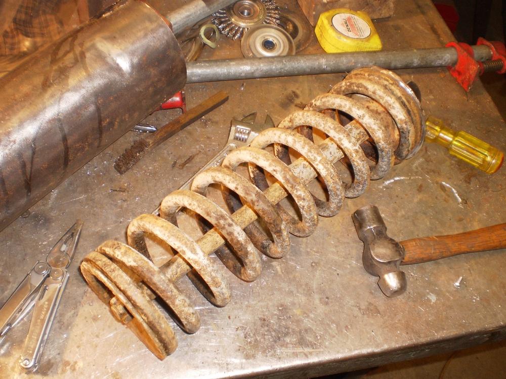

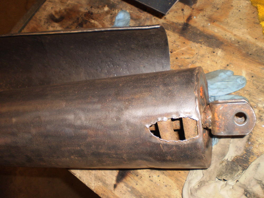

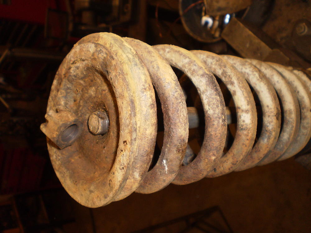

J5 Bomb. Thanks for pointing that out! I completely forgot about the stop pipe inside the spring can. It's been 5+ years since I restored my J5 but after looking at some old photos of when I opened a can up to repair a wear hole I see the stop pipe now plain as day. I will be sure to confirm with Dan that it is present on his new bogies and report back. You may have saved me a headache down the road I'm glad you shared that knowlege!

Dan Builds these cans so if you give him the length of stop pipe he do it
Snow buses have a stop pipe but not sure how long
