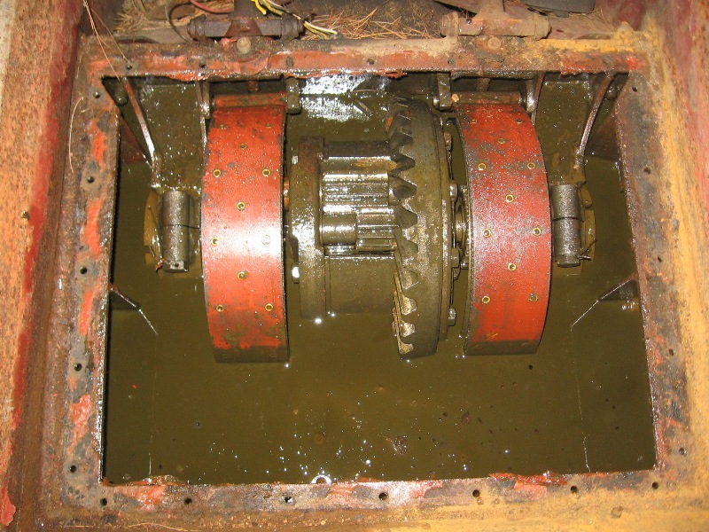

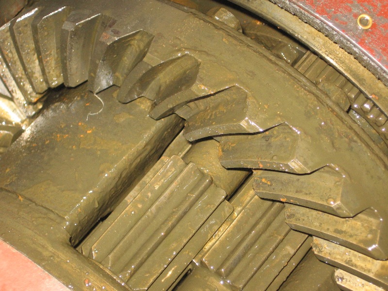

Is this your first run since the hull rebuild, or have you been using it for a while ? If the track tension is all right, you might want to drain that diff and take that cover off. Those 6 pinion gears get pretty delicate as they wear , best to make sure they have all their teeth .

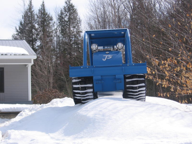

Throw a few pics up of your finished project.

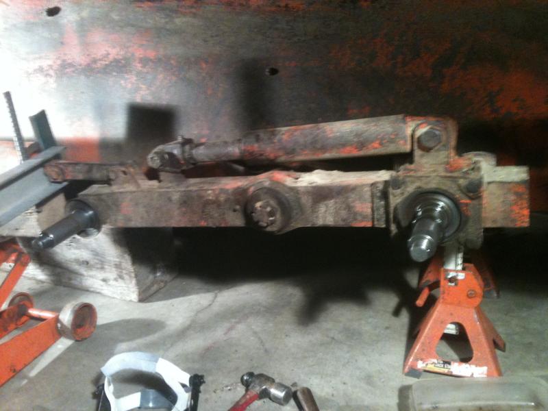

When I put it together the gears looked fine to me. I cleaned it up(the picture was before that)and replaced the bearings but not the brass bushings. They were a little loose but not bad. If tightening the tracks doesn't work I will pull the cover and take a look. I have not hauled any wood yet. Still having minor issues. Last winter I was having an overheating issue. I had a 2 core radiator an I was blaming it on that. Last month I bought a 4 core aluminum radiator and thought I had solved my problem. I took it out and rode around for around an hour. The temp came up to around 210 and stayed there for most of the run. But the last ten minutes it started to climb. I parked it in the garage and after a minute blew antifreeze out the radiator. I don't understand why it won't run cool. It was around 10 degrees that day. I have just installed a plow and am hooking that up. I'll get some pictures of that soon.

Keep the pics coming J5 Bombardier

I had the Same clicking noise due to guides hitting spring can just after restoring my J5 and track rebuild. My track tension seemed ok but the rig would begin to bounce or "porpoise" after hitting a few bumps when traveling along. The clicking would happen when busting through crusty snow or hitting bumps and tussocks. I determined more track spring tension was needed "not just tighting the tracks". You can add more spring tension to the track tensioning wheel by moving the spring link to the second attach point on the walking beam. I don't have a great photo of it but you can see in the photo on the left side of the walking beam where the link that comes from the spring in a can, you have two mounting holes that give you more or less spring tension. I added more tension and it ended the clicking under normal driving conditions. But I have very briefly heard it happen again but only when climbing over a big log and going to fast while doing it. It made for a stiffer ride but decreased the bouncing while traveling effect allot. Im assuming this condition is due to my springs are old and have probably weakened over time. But I plan to use them this way until they bust.
