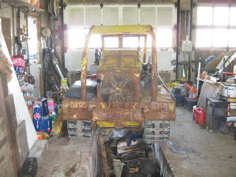

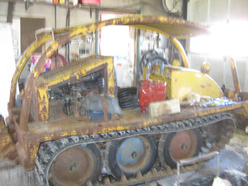

Hi all, some good news and bad news. The good news is it got the old flathead running after it's ten year sleep. new plugs,cleaned the points, cleaned the carb, cleaned the fuel pump, and a bit of priming and presto she's running. took it out of the garage and had a little ride and was very pleased. Bad news I went less than 1km and burned 2 gallons of gas and about half gallon of oil haha (I was told the motor was bad when it was parked). Then a rim exploded in the back and I limped home. This was a fun project to get it running and now when I get time I'll be ready for the next stage-take out the flathead and 3 speed and put in a modern 4 cylinder EFI and an automatic. Any suggestions for a donor motor?
a few pics.

Nice Pics! Now that has to be one of the oldest J5's posted here so far, judging by the small axles and the early style differential cover. Keep those pics coming!

Old Green J5 the 1959 model I just finished in the Restoration forum had the newer square box diff housing,so that would make yours older.The round style like yours tend to crack(something to check).The brass Bombardier oval tags on the rad screens usually survive, but on all the examples I have seen the ser: number line is always blank . Others have mentioned the left front of bombardier hulls have stamped serial numbers,but after years of abuse and mods I have never seen a stamped number surviving.
