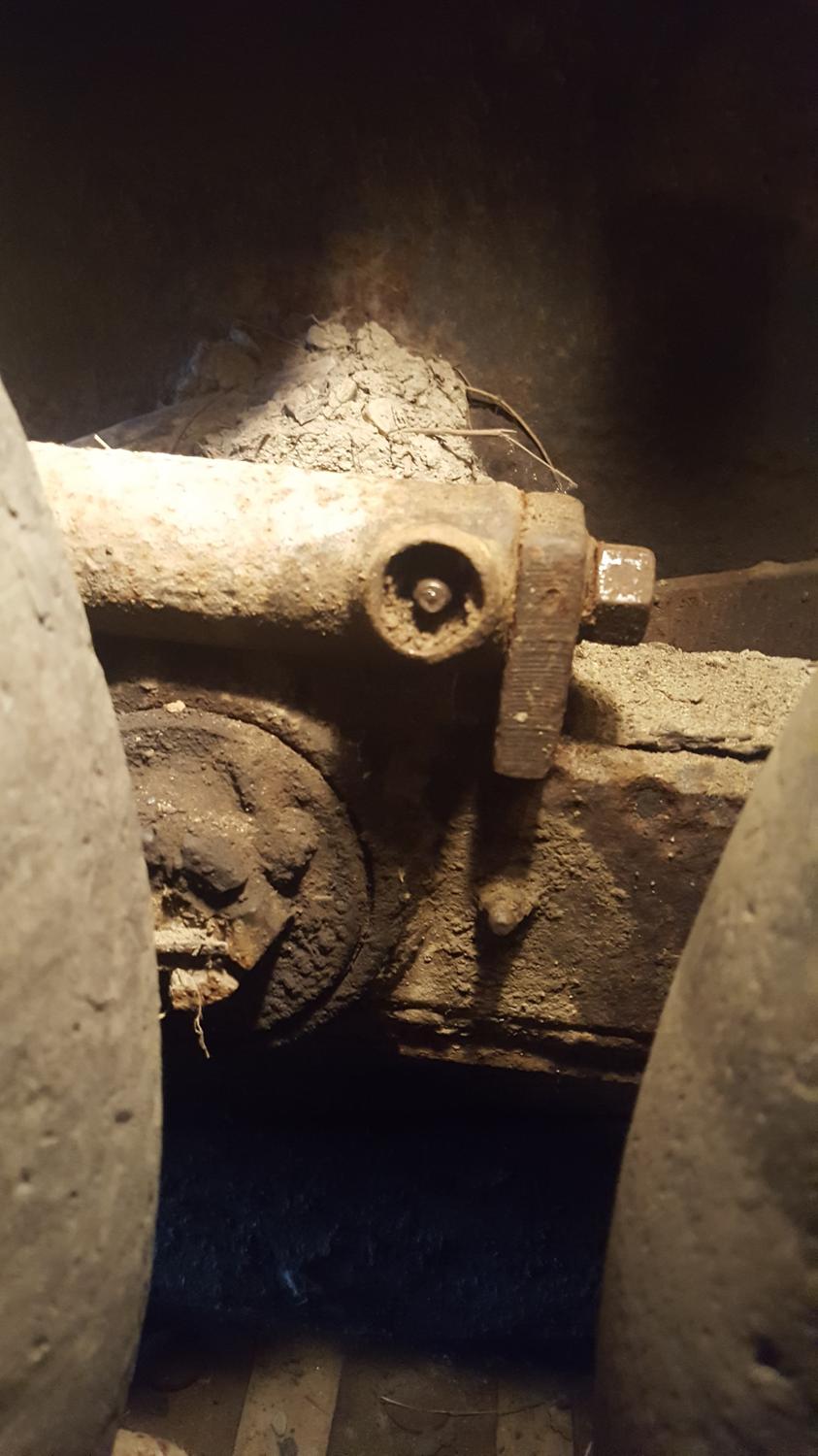

ok, so I bought one. are these manual track tighteners? have to pull the tracks to replace a few wheels. I see I have a lot to learn. also, looking for a manual for a j5. thx!

You pump grease in the track adjusters to expand remove the grease zerk to collapse
This is who bought it, sold with a T-6 log trailer
I modified a socket to fit the zerk for removing grease that was kept in my tool box. it had a pointed extension on the socket that worked pretty good.
so I bet I should have removed the zerks before I blocked the machine up off the ground, right?
No, you can take them off after it’s up,normally they are so stiff and rusty that
They barely move with the zerk out.
You can remove the nut on the end, and after you get it to collapse a couple of inches,remove the complete track adjusting cylinder from the machine for disassembly or cleaning. It’s a good idea to replace the zerks from time to time with the highest quality you can find. So they don’t bleed down under pressure
You can push the ball in on the zerk if you think there is a lot of pressure before removing. (Flat end of round solid rod say 1/4)
Note, if you want to disassemble the cylinder after removal, for cleaning or inspection, just pump some more grease into it.

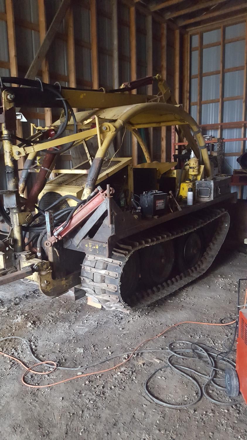

to remove the nut, will I have to hold the cylinder firm, or will it only turn so far on its own before the nut starts loosening off?

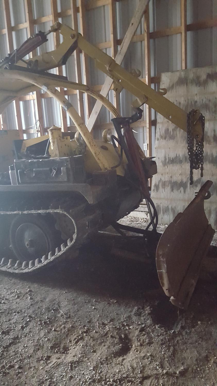

yes it has a load on. I will be removing all of the overhead boom stuff, as I don't have a use for it. bought this to use on my traplease to help keep the trails open, so I think the front blade will be handy. this machine runs like a top, except now, all of the sudden, it quit starting. just a "click". starter doesn't seem to be engaging. tried to bypass the solenoid, and same thing. funny, cause it always fired right up. so, I guess the starter will have to come out before anything else gets looked at.
Yes , a blade is handy , I use mine to clear the skid way and when skidding the extra front weight helps. When not doing that it comes off, less weight and drag on the front.
