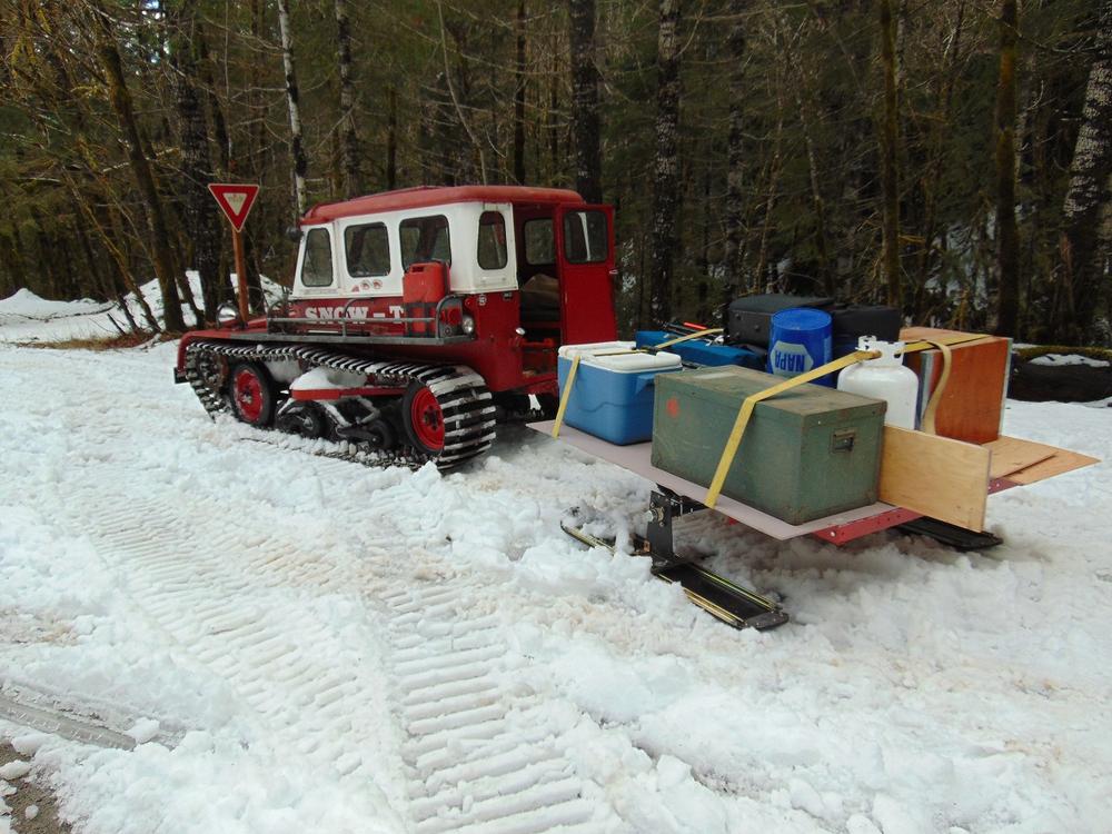

Looks like fun... tell me about your trailer. I’m thinking of building one for my cat. How did you fab the ski?
First, my trailer had to do two purposes: Ski trailer and rock shield. If you want a world class model look at the one made by Mikemikelle. His is the target.
I wanted the following functions: As light weight as possible. Both a trailer and a rock shield. Cheap as possible.
The chassis is a cheap harbor freight folding trailer 1195 lb. I cut two 1 ft sections out of each side leaving a 6 ft trailer. The deck is 6 ft wide of 3/8ths plywood.
I used "SuperStrut" for the steel members and cut up sections of old water pressure tank for the ends. The ski is 1/2" UHMW 10" wide x 5' long (yeilding appx 1000++ sq inch bearing surface for the pair) There are 2 runners per ski each 30" long of 1"x1" UHMW. For the area not covered by the runners, the bolts are 1/4-20 with nylocks. The runners are tapped 1/4-20 and bolted through. Heated the UHMW to bend to the ends and then drilled and bolted them with counterbored holes in the UHMW.
I can post more images if you want. But mostly it was just a "what do I have, and what can I make" project.
The rock shield portion: It folds up to a 3 ft high x 6 ft wide barrier that mounts on the haul trailer (ski removed) to keep the front of the trac from being pelted with rock.
