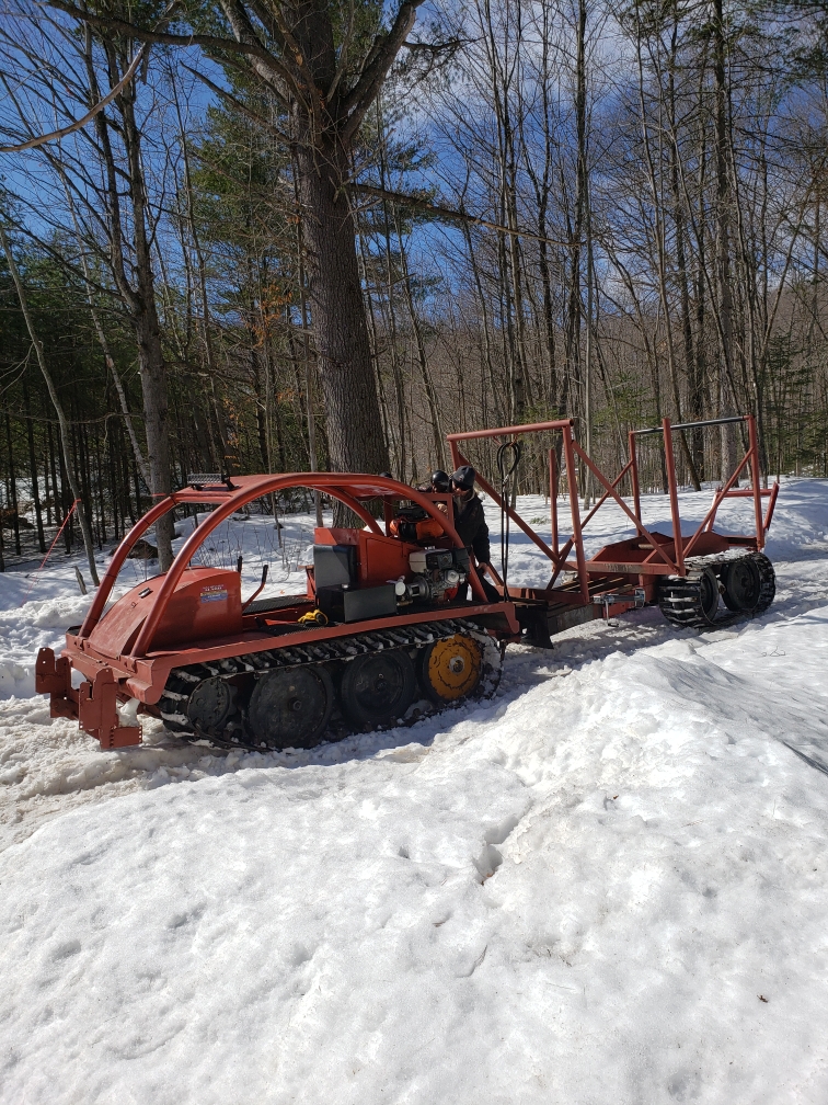

I bought this red J5 with trailer last week and inherited a few problems of course, needs some work and I generally am a video kind of guy but can post some pics as well.

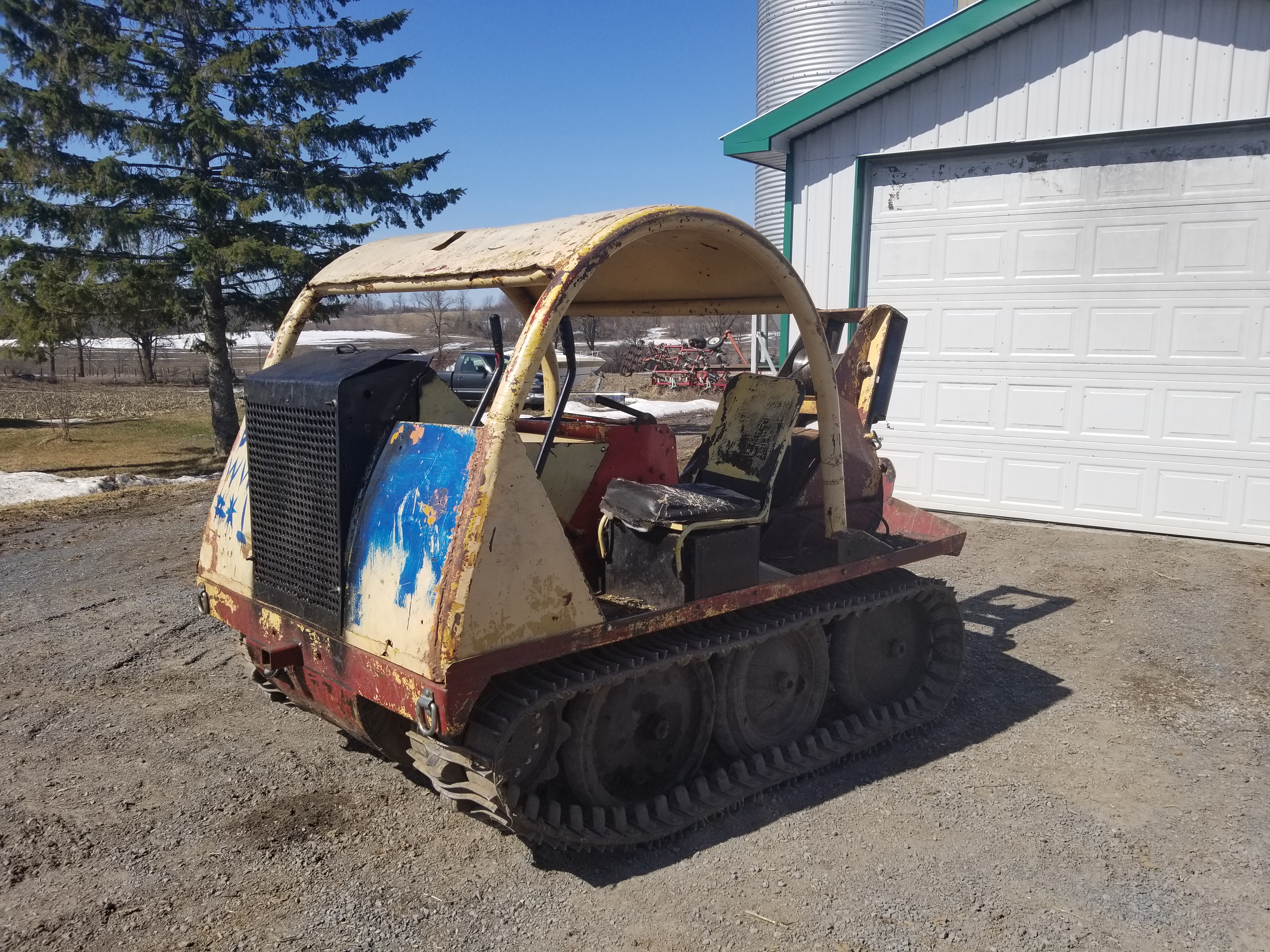

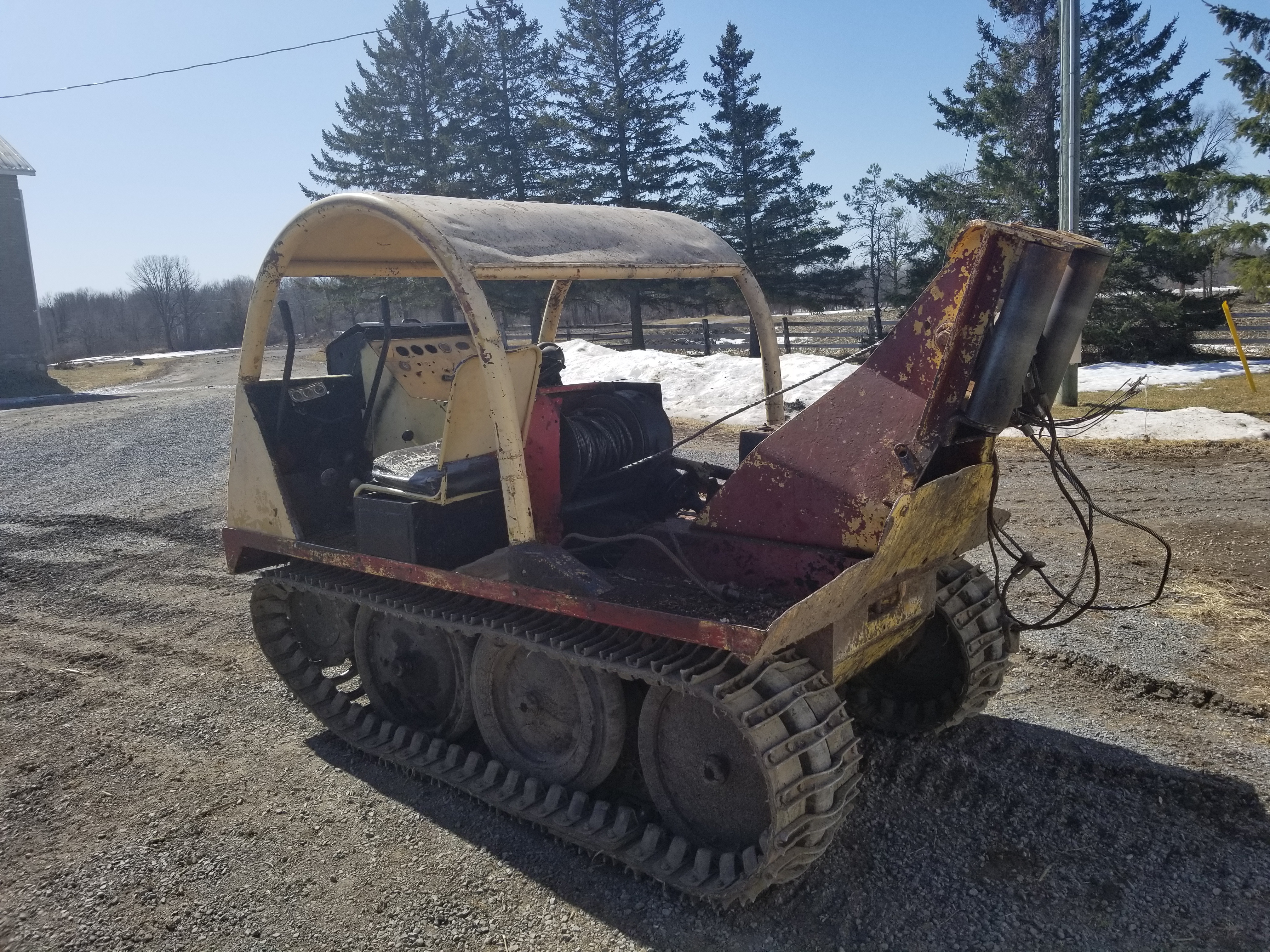

The yellow one with blade has 13.5 wide tracks, hydraulic pump off a belt on the motor. Looks like it had the jet fighter hinged cab. Lots of good parts on it.

Issues:
1. Motor mounts - are shot...engine pretty much slams from one side of the engine bay to the other.
Need engine mounts all around.
2. Just started running with a miss- that is a bit intermittent. Looks like a fuel line is crimped a bit and Carb kit needed, upper bowl gasket leaks. Drained the bowl no change, went up a hill and ran better for a while - possibly Fuel pump?
Needed:
BB Carb kit square top carb - I think the Hygrade 101A is needed. See video coming soon.
Fuel pump
Fuel filter
3. right side control lever oscillated when driving, still runs great - I suspect the drum in out of round - is that a big deal?

Also, my engine oil pressure (if the gauge is right hovers just under 20PSI, seems kind of low. Apparently the engine was rebuilt 4 years ago...I wonder if there is a sump screen that can be cleaned?
Nice! Somebody did a good job grafting that skidder mast on. Respect that mechanical winch, it will take no prisoners if given the chance. Keep the pics coming.
