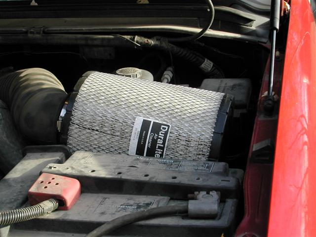

Geez, I'm feelin like LBrown replieing to himself. Got the Wix filter installed this afternoon. Sure made a difference. The engine definetly is getting more air now, and the turbo seems to whine a little more. Just that has turned the truck on. I've still got the 4" turbo back exhaust to put on, will do that later this week I hope. Wish I'd done the filter thing a while ago! It was the cheapest mod I ever did, $42 including taxes!:a1:
John, In the Cummins circle we call the filter you installed a BHA (Big Honkin' Airfilter), and it's a common mod. Much higher cfm than a K&N without the lack of filtration. I threw away my K&N after discovering the dust in the pipe just ahead of the turbo!!

BA; Here's the photo of the airfilter I installed. Can you say "huge"? :coolshade

If you had MAF problems, you'd know it...driveability would suck! It would stall, stumble, hesitate, etc. Since it's a fairly critical component of OBDII, the SES(check engine) lite would definately be on. Here's a tip to remember...if you ever experience those types of conditions, unplug the MAF and see if it makes a diff. If it improves driveability considerably, you got a bad one. or you can "lightly" rap the sensor with your hand and see if the engine reacts to it. If it does, again...it's a sign of a bad MAF.
I'd be curious if any MAF code set, but I doubt it since you said this rig runs strong. Plus no mention of the SES lite either.
That filter is a big plus and it's starting to become the norm for OEM design, especially trucks and SUVs. I tend to agree with Junk about the 4" exh though, but as long as it works for your needs...leave it.
