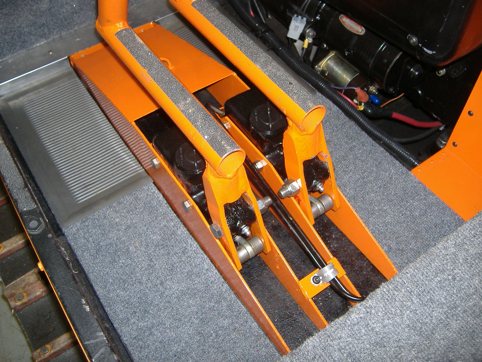

The master cylinders are for a mid 61-67 Ford Econoline van. They must be used on a lot of other things because there are lots of them on Ebay. I got mine for about $80 each but that was a while ago. You have to narrow down the sides to get the levers to fit.
I just got some installed on mine and the levers certainly sit closer to the driver.
Is narrowing down the sides required, or a convenience thing?

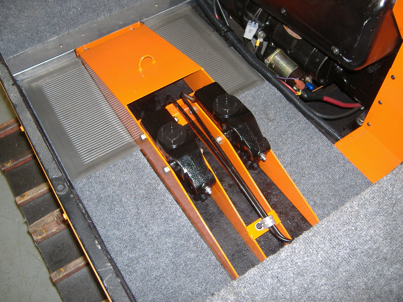

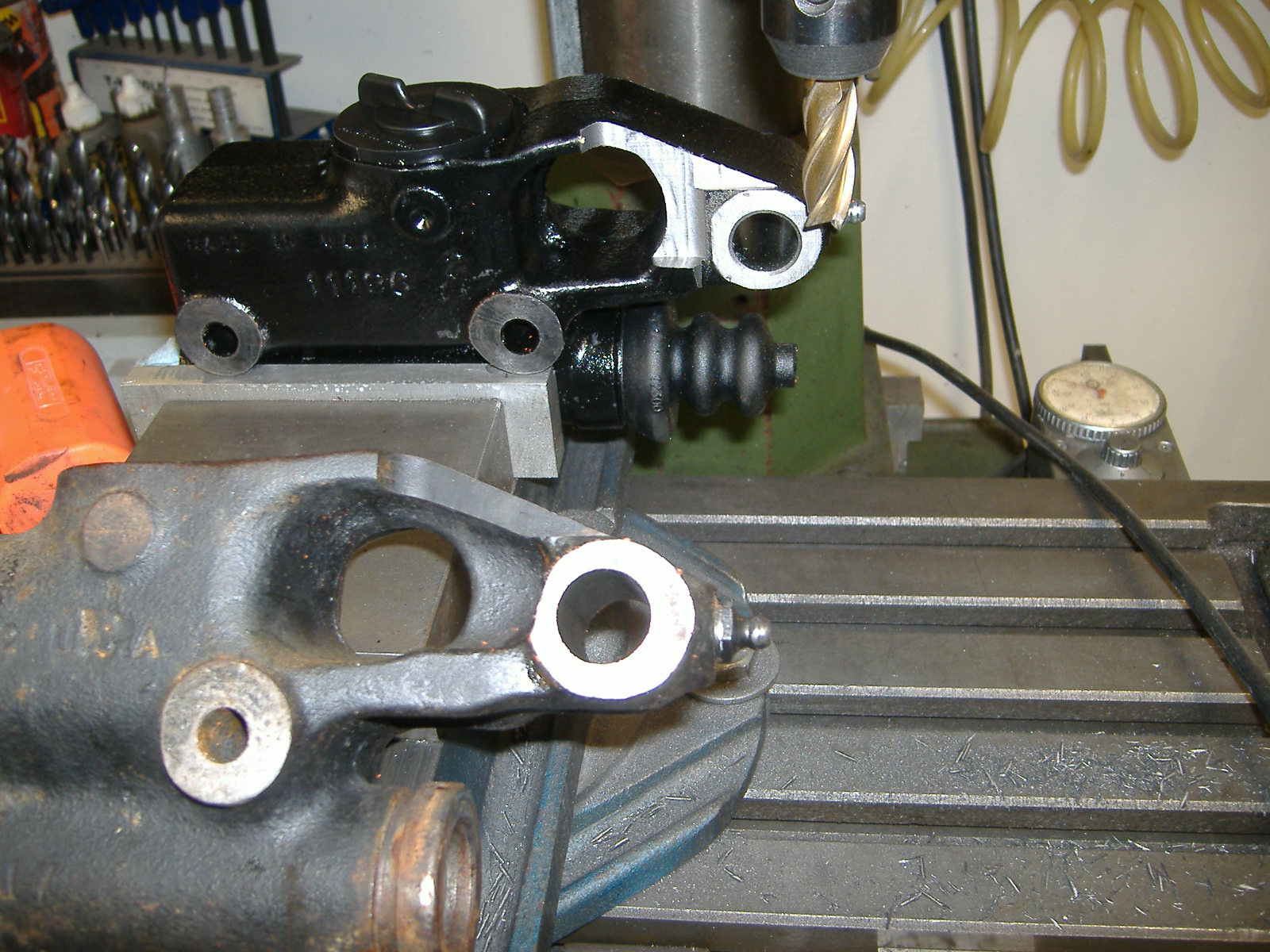

Take a look at your old ones. The upper cast web on the new ones is too wide to allow the tangs on the levers to go fully forward. Thiokol modified them so the levers could get full travel. In the Ford van, the brake pedal was under the cylinder so the web did not interfere. The forward bottom of the lever tube that is welded between the tangs should hit the top of the cylinder with the levers fully forward. Mine looks different because when the cab was added the levers were modified to make it easier to get in and out and to allow the levers to have full travel due to the seats being larger and further forward (Honda CRV seats). The tang section is still original. The stop on the bottom of the tube can be ground (or have a piece welded to it to make the levers even with each other
The picture without the levers shows the cylinders when I was fitting them and before the web was milled. If I remember correctly I think I also had to narrow up the pivot bore area to get the tangs to fit without being too tight but I may be wrong. See the photo in my earlier post.
