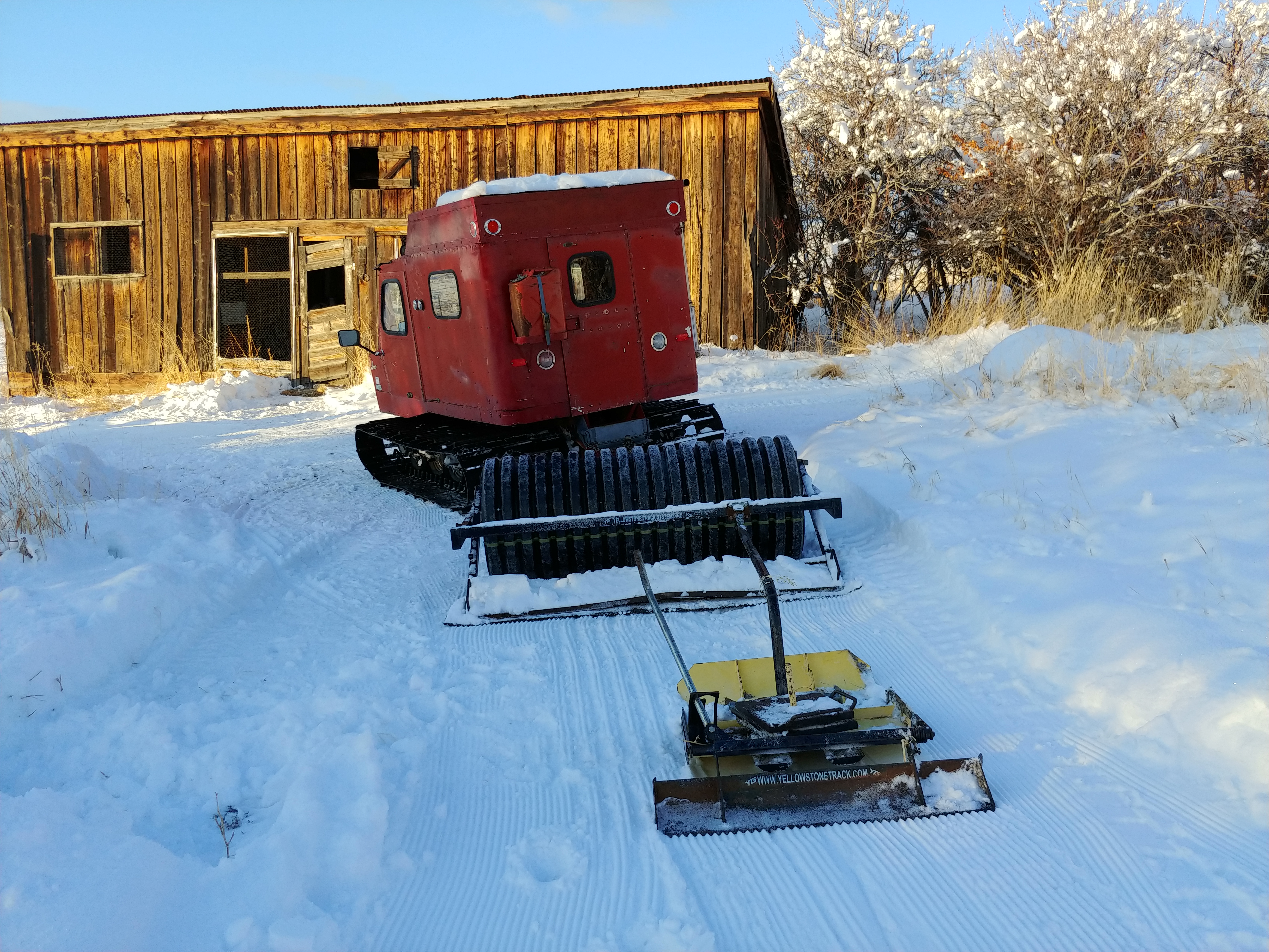

I have a 1404 Thiokol Imp ford v4 1974, model 32 inch tracks, extra belt, 2 gas tanks, the back passenger headroom is lifted a foot, the clock says 472 hours (seems low but it had about 350 when I bought it.) I've just used it for setting a cross country ski track. Don't know how to price it any advice would be appreciated located in Fairfield Idaho

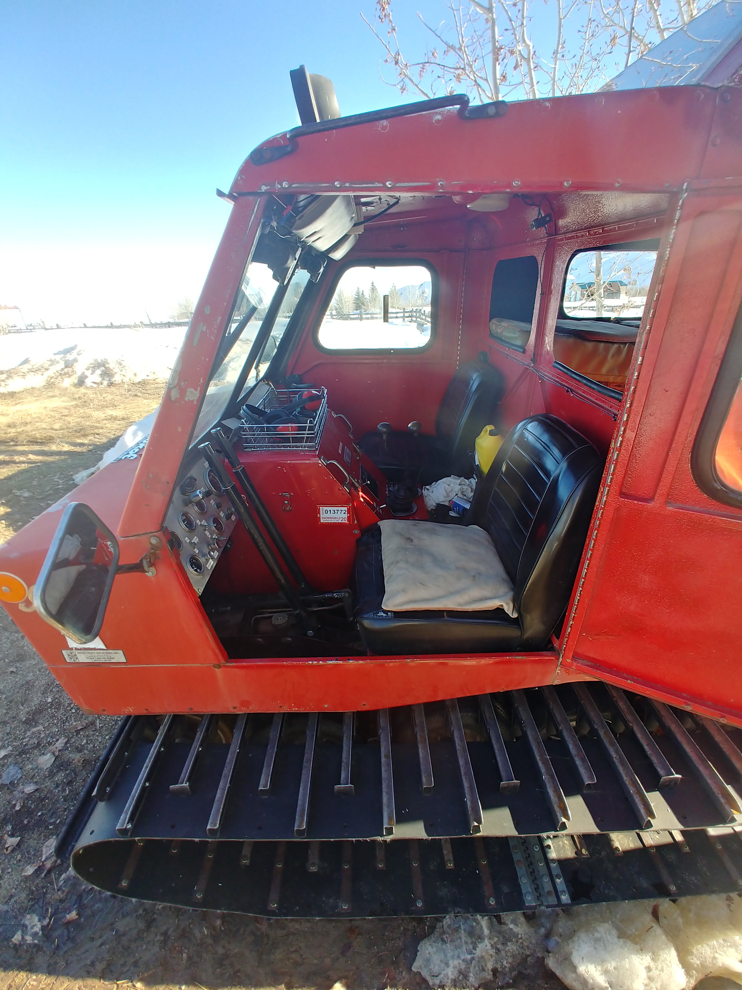

So here are some pics. The trailer (haven't decided on selling it yet) is 4 wheels tandem with a cast aluminum deck and pull out ramps that store nicely underneath. Strap attachments fore and aft.
The cabin has a cushioned bench on top of a long tool box on one side and a lift up bench (legs fold in) attached to the left side. Some glued on soundproofing. I do have windows for spaces between cab and cabin.

Wow, That’s a clean unit for sure. What is the serial number? Can you tell me what carb is on it? If the ignition System checks out, It almost seems like it has water in the fuel. what do the spark plugs look like? what lead up to the no start condition? is the firing order for the plugs wired correct? That ford v-4 should bark right off. I’d say pull the plugs and clean them, and check for correct plug wire sequence/firing order. when You say you’ve been through the distributor, have you actually checked for spark? It’s gotta be something simple. Hang in there.
