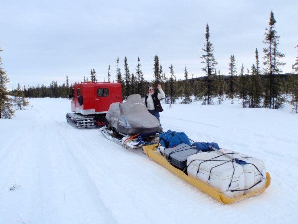

My Imp acts very similar to CloudCaps and SlowCatDriver's posts. This is the first trip up to the cabin. It's a 20 mile run on hard pack. If I remember right It burned under 20 gallons. And my tracks are snug fitting. I broke a steering band at the cabin. It was late last year so I am going back soon without hauling the wide track LX.
