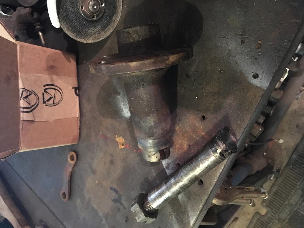

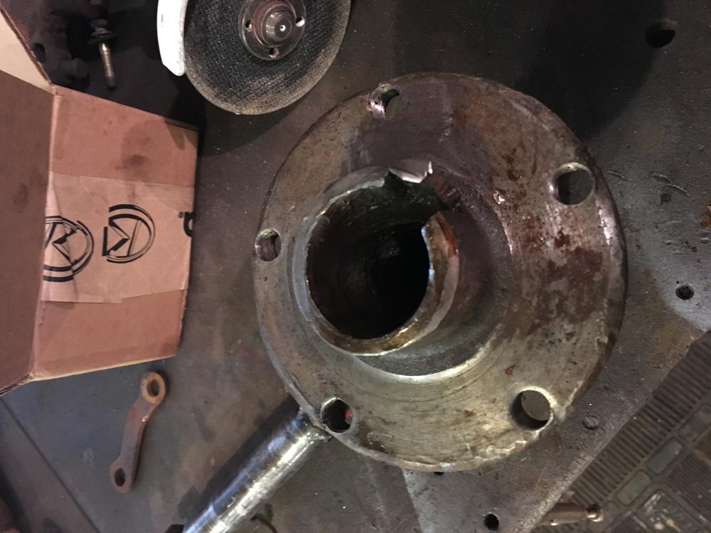

Thanks for the help. I got it apart. Looks like I will need an axle and a hub. Are these both dodge truck parts. The axle broke at the end of the taper. I think the key broke first. Probably quite a while ago. Thanks again for all the help.
They are proprietary to Tucker if they have extension after the taper. Hub also. How did the hub break?

Here are some pics. As of right now I can't get the axle shaft out of the axle housing.

Those are the long and it looks like your hubs have been spinning on the axle. May want to check the others so you don't repeat the issue x 3 more.
Also an observation the race looks like it further into the axle house than it should be. Race should be a little proud and then those thin metal shims that should be on the retainer are used to adjust.
Without filling that space between retainer and race your axle and everything hooked to it can slide back and forth potentially causing more wear and damage.
Some shims like the race should help. Another axle may change this. I have seen a few tucker axles and the bearing stops are slightly different .
Yes. it is the newer long axle type. That axle is toast, weld a nut or anything on it and use a slide hammer to remove it, should come out without much trouble. That hub may or may not be recoverable by welding and re-machining. To bad he did not stop when it first failed. You could weld the broken piece on just to pull the axle so when you pull the other side for a pattern to make the new one, you will have it all figured out how to pull an axle. I do not recommend trying to weld and use the axle. If you make several axles, you could sell them and pay for the repair. I know there are folks who need them, I am running out too.
