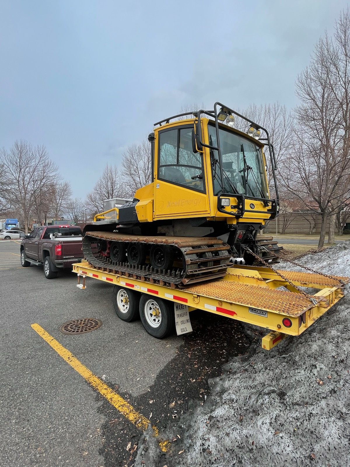

Its 1.6L ford 4 cyl industrial, 12 gallon tank, max speed 20 mph , 4 gears. Does not have space for sleeper truck type, but if u make a frame u can mount roof tent. For a sleeper you need bigger machine something like Prinoth Trooper/Patrol, LMC 1800, PB Canyon , Thiokol 1202 mid size machine . I had these Bombi, Prinoth Patrol and Argo Centaur, kept only Bombi. Lightweight, easy to go remote places and small trails. With battery powered air diesel heater any ice fishing tent is perfect for camping overnight on a cod.
