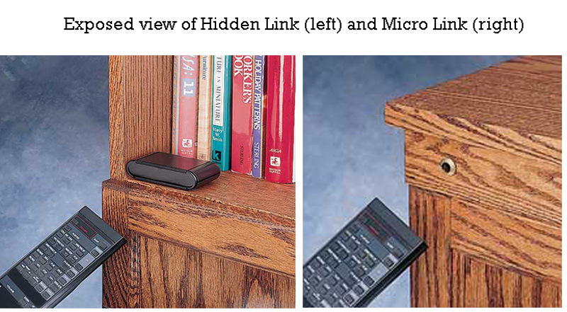

Rockler.com (Rockler Woodworking catalog) came to the rescue with all the components I needed in a simple to install kit. Rocker offers 2 different systems, the Hidden Link and the Micro Link. Both systems use the same components except for the receiver unit. The Hidden Link is larger and can be set on a shelf. The Micro Link needs to be installed into a 1/2" hole that you drill into the face of your cabinet. Because of the configuration of my TV enclosure, which opens to expose not only the TV screen but also the speakers, I had enough room to place a Hidden Link receiver (it is about 3" wide x 1" tall) without it being visible so I opted for the Hidden Link.
I was amazed at how easy it is to install. I don't know about you folks, but for me, something that should take 20 minutes is typically given a 40 minute allocation and often stretches to 60 minutes. In the case of this system I figured it should take 20 minutes and it only took about 10 minutes!
Everything is included to run 4 components. I have 4 components so I did not need to add any extra emitters. You start with the emitters. They simply stick onto your components IR receiver port and have a very thin wire that you run back to the connector block. 1 emitter was attached to each component (TV, DVD, Surround Sound Unit, Satellite box). The Hidden Link reciever and the power supply both plug into the connector block. You simply set the Hidden Link receiver unit where it can receive a signal but still be out of the way, and you plug in the power supply. That's all there is to it. No programming. No nothing. It just works.
