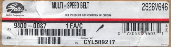

Hi Bill, I live in a little hick town and I can get those belts, no problem. I have got a couple of them from a industrial bearing, belts, type place. They are Gates #2926V646 Multi Speed Belts, and I paid approx. $100 Canadian for them and got them overnight. Hope that helps. Arlow

By the way for people in North America, here is a current supplier for Variator Belts. Washington Belt www.wabelt.com
As pointed out by Arlow several posts above, it is a GATES brand Multi-Speed Belt, #2926 V 646

Many of you probably know this, but industrial variable-speed belts have a m/l universal product code, so the Gates # posted above is it's own cross reference! The # 2926V646 encodes the belts measurements like so:
"29" it the top width of the belt in 1/16ths, 29/16 = 1 15/16"
"26" is the sheave angle or the taper of the "v" in cross section
"646" is the outside circumference of the belt multiplied by 10, 646 =64.6" or likely cataloged as 65". . . look about right?
Do a google search on 2926V646 and you will find many suppliers. Most industrial supply houses (eg. MSCdirect) will stock them too.
Hope this helps - Paul.
