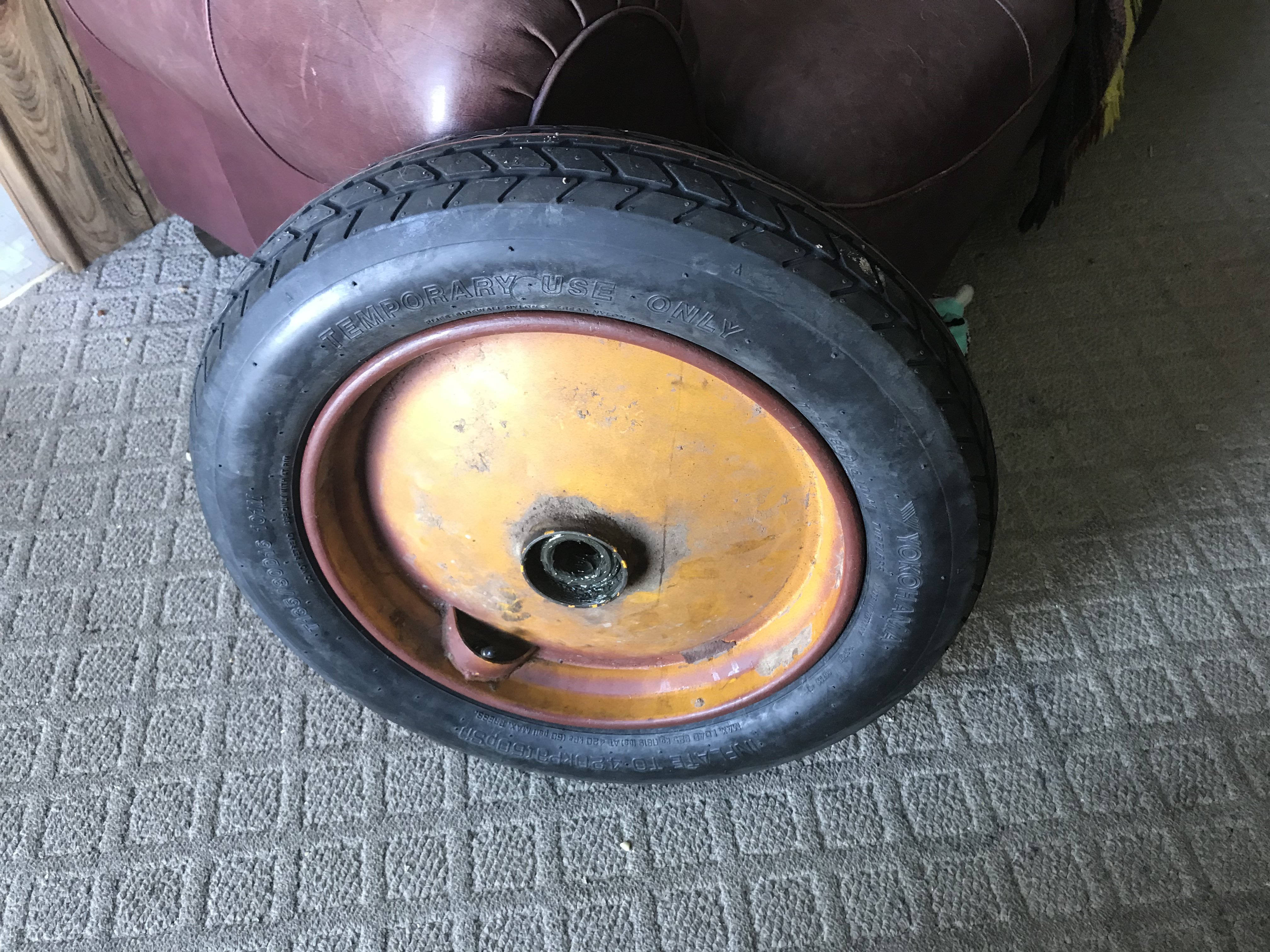

I have begun the process of replacing all my old tires with doughnut spares and high pressure tubes. The numbers are in, the foam filled original tire and tube weighed 73 pounds! The air filled Yokohama weighs 34 pounds. I found that the foamed wheels are nearly impossible to hoist back onto the axel alone, especially if the track is still on. I’m done with foam. Never mind it costs an additional 50 dollars per tire, there is just too much weight penalty and they have to be cut off with a reciprocating saw.

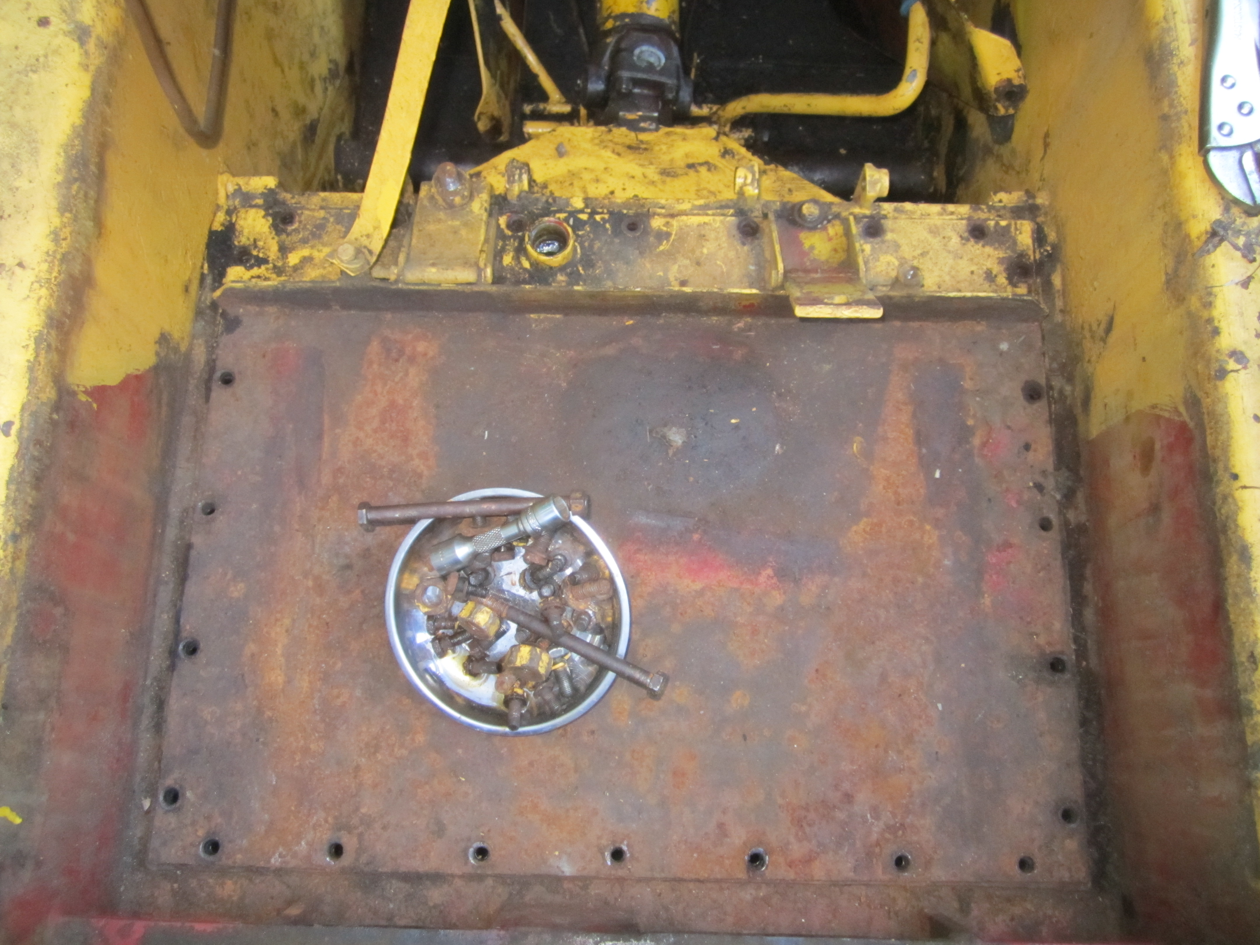

The steering band are located in the differential in the front under the fuel tank. This is how it looks like after you remove the 'dash' and the fuel tank:

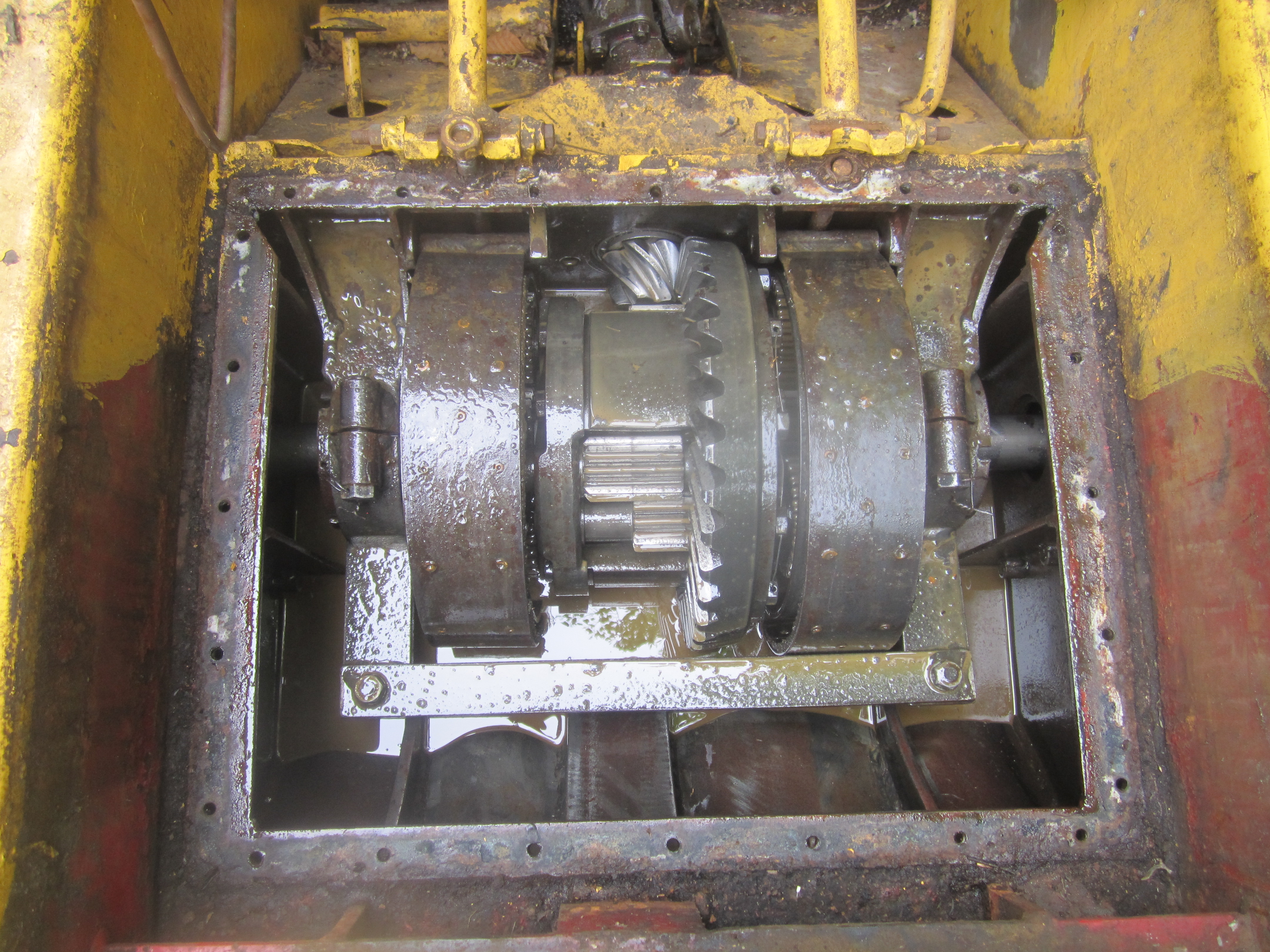

After you remove that cover, you should see something like this:
As you can see below, this picture was taken when it was really contaminated. The two bands are tightened by pulling the 2 bolts shown on the top of the picture by the 2 levers you can see on the top of the picture.
jf
