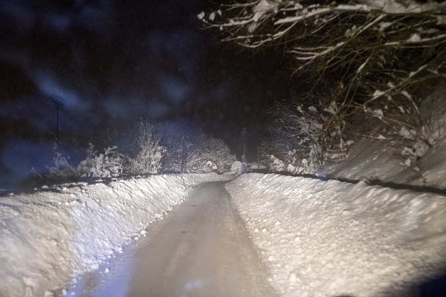

I talk to them about respecting others and ask them not to block the road
Then I take my cat with blade or dozer and push it all in there driveway
