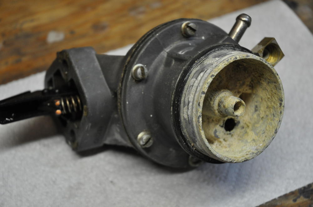

I went to replace my stock fuel filter last fall and found a foamy jell everywhere inside the canister and completely coating the filter. You can see the cake after the junk dried. Occasionally in spring I get vapor lock so I pulled the mechanical fuel pump, installed an electric fuel pump, and replaced the entire fuel line with braided hose. I added heat shield around the hose above the engine and a second clear filter after the solenoid fuel valve. When I finished, I filled the gas tank, added stabilizer, and all ran fine. After sitting idle for two months in warm/cold fall weather, the engine started, but I couldn't move the cat because it would die when I put load on it. My new electric pump died with less than one hour of use. I replaced the electric Carter solenoid pump (very quite) with a new Carter vane pump (noisy) and added a can of SeaFoam. The engine fired up and ran fine all winter. Due to a drought snow year, I didn't use it much and only used about a tank and half of gas. For the last few months, the cat sat idle with a half tank. I fired it up this weekend. The engine ran about two minutes and then stopped and won't start. My latest fuel pump died. Both fuel pumps had brand new standard inline filters immediately upstream of them.
I have had this Spryte 9 years and only once had a water issue. A little ice accumulated in my fuel filter. Warmed the filter and put in a can of SeaFoam and all was well. I installed a new aluminum fuel tank 3 years ago. It is on the rear deck like the one it replaced. The tank is more boxier than the old steel one. I don't know if the aluminum or tank shape is causing more water to collect in it.
At this point I speculate that water accumulated in the fuel tank. The small filter got overloaded with water and this choked the flow to the pump or something like that. I did some digging on the Carter site and found that too much water in the fuel, especially if it separates, can kill a pump. They don't really say how or why.
I am thinking about adding a marine type fuel filter that has a drainable water bowl on it. I think Kristi's use something like this. Has anybody else used this type of filter? Also, has anybody had a similar problem? If so, how did you fix it?

Hummmm … Time to look at what the marine and aircraft industry do about water in gasoline with ethanol. Boats use the same gas as cars and snowcats. It turns out that gas sucks water out of the air very very slowly. Mercury Marine says it takes one gallon of gasoline over 200 days to suck 0.15 teaspoons of water out of the air at room temperature at 100% humidity in an open container. Ethanol absorbs water even slower than gasoline so gas with 15% ethanol would take even longer to absorb the same amount of water. They way water is getting into the fuel in your tank is either - it is in the fuel when you put it in your tank, it is leaking into your tank, or it is condensation. Mercury says the main way for boats is condensation. Also, the less gas in the tank, the more condensation you get so keep your tank full.
The big difference between gasoline and gasoline with ethanol is the physics and chemistry. Gas with 15% ethanol can hold 3.8 teaspoons of water in solution at room temperature or about 25 times as much as pure gas. If you add more water than it can hold in solution, the water just remains as water. The problem is when the temperature drops you can get phase separation. When the temperature is 20F, the amount of water each can hold in solution drops by about half from what they can hold at 70F. When you have more water in solution in straight gas than it can hold, the extra water comes out as essentially water. So you have gas with water dissolved in it and some mainly water stuff in your tank. When gas has ethanol in it, the “extra” water in solution comes out of the gas and takes the ethanol with it. The water/ethanol mix can combine with other things in the gas and debris to form a gelatinous emulsion (their words – not mine). This emulsion is very viscous and stops up pumps and filters. (This is probably what I say in my mechanical fuel pump and killed my electric fuel pumps.) Since the emulsion has no lubricating gasoline in it, the fuel pump does not get lubrication and fails. Just 10 gallons of fully saturated gas with ethanol can create nearly a cup of emulsion. Also, ethanol is higher in octane than the gas so the ethanol-water mix is high octane, like 115, and the separated gas is low octane. Neither is good for the engine.
Water/fuel separators with good fine (10 micron) filters are standard equipment in planes and most boats. Adding a filter with a water bowl seems like a pretty simple way to protect a fuel pump and carburetor so I am going do that. Then all I will have to do is to remember to drain the bowl and keep the tank full. I am thinking about adding a cover over my fuel tank to keep the snow from sitting on the tank. This supposedly helps reduce condensation.

All the boaters and Amish run ethanol free 94 octane and never have a problem. My riding mower runs fine on regular as do my old B&S engines. My 2 cycles only get the 94 ethanol free. It almost looks like algae is forming in that one pic. Clean the tank real good and add some algaecide to some good fuel. A water trap sediment bowl should help protect the pump.
