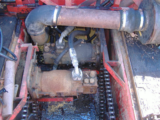

Here are some pictures. Its a 5 man cab, 300 ford industrial engines, Sunstrand hydrostatic drive, 32" wide tracks. I bought it locally from a gentlemen near Drayton Valley, turns out he is a memeber here (teamster) and he told me about this website. Anyways so far i have rebuilt the carb, did a full tune up on the engine, lubed the steering calbe that were very dirty and stiff, and use about 3 cans of degreaser and pressured the whole thing. I also flushed the hydraulic system twice, and replaced a couple of out hydraulic lines. she starts, runs and drives ok, she can turn on gravel but when trying to turn on grass it bogs down the motor and has no power so im going to remove the whole hydraulic system and clean everything and rework the ports on the hydraulic tank.
