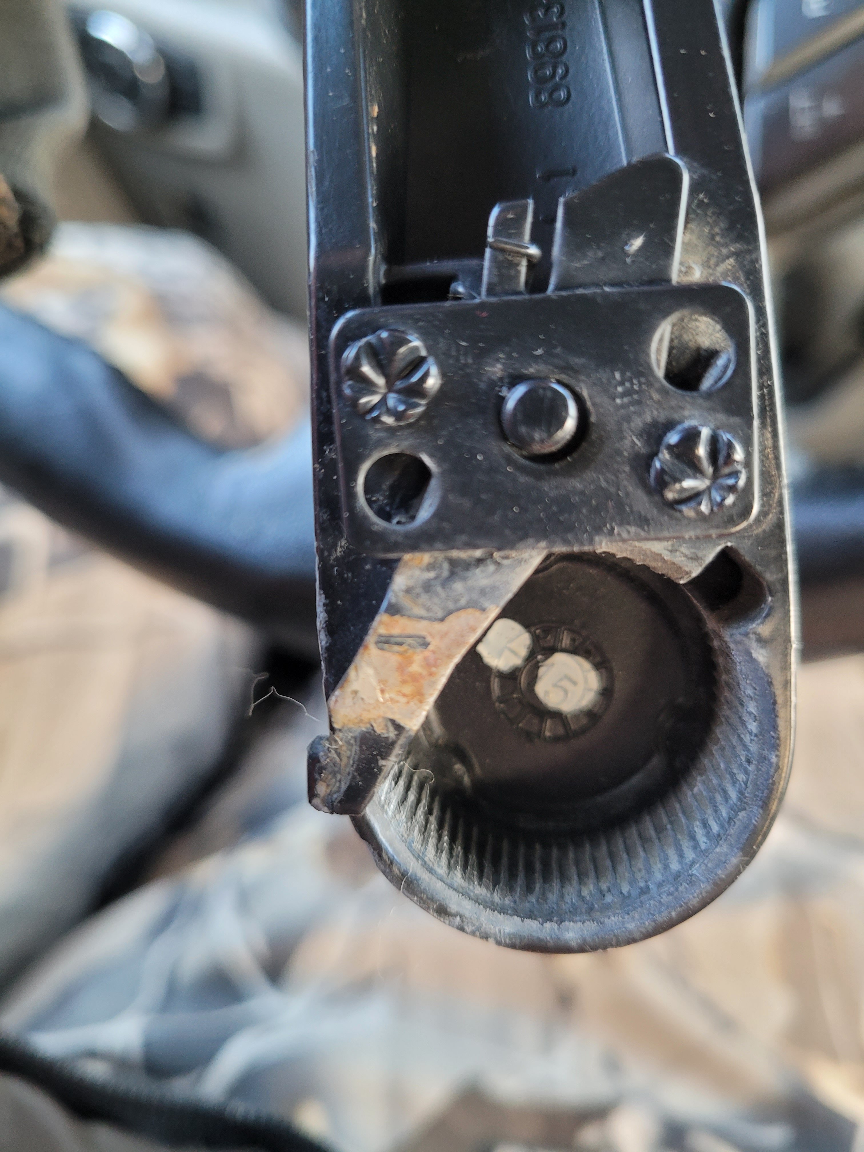

Next, the original arms attach by sliding over a splined shaft. If you look closely, you can see very fine teeth. That's all that locks the arm in place. So any little bit of resistance such as snow ice or salt on the windshield and those thin splines strip.

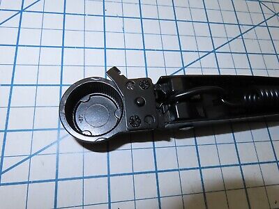

Ford says that there's no problem. But they have redesigned the wiper arms and added a locking pin in place to keep it from stripping.

Here's the inside of mine. Notice the splines. That's all that holds it in place. Any kind of resistance and it strips. The new one has a keyway in that Grove. The original ones didn't.
