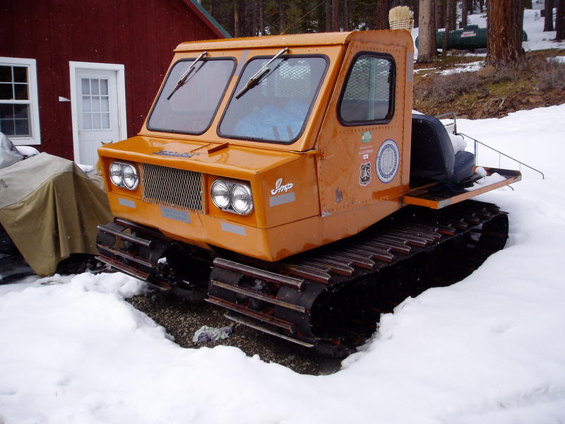

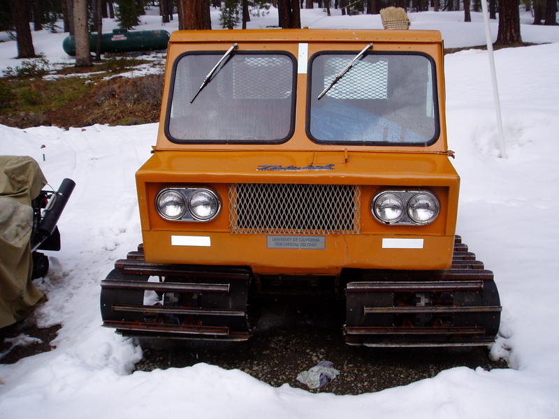

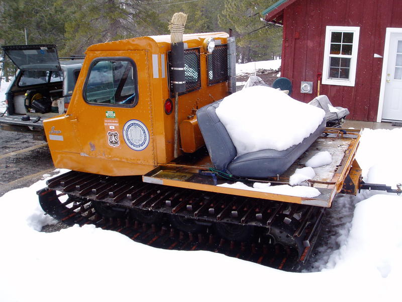

that thing might need a little tlc but it's a fine looking little imp
