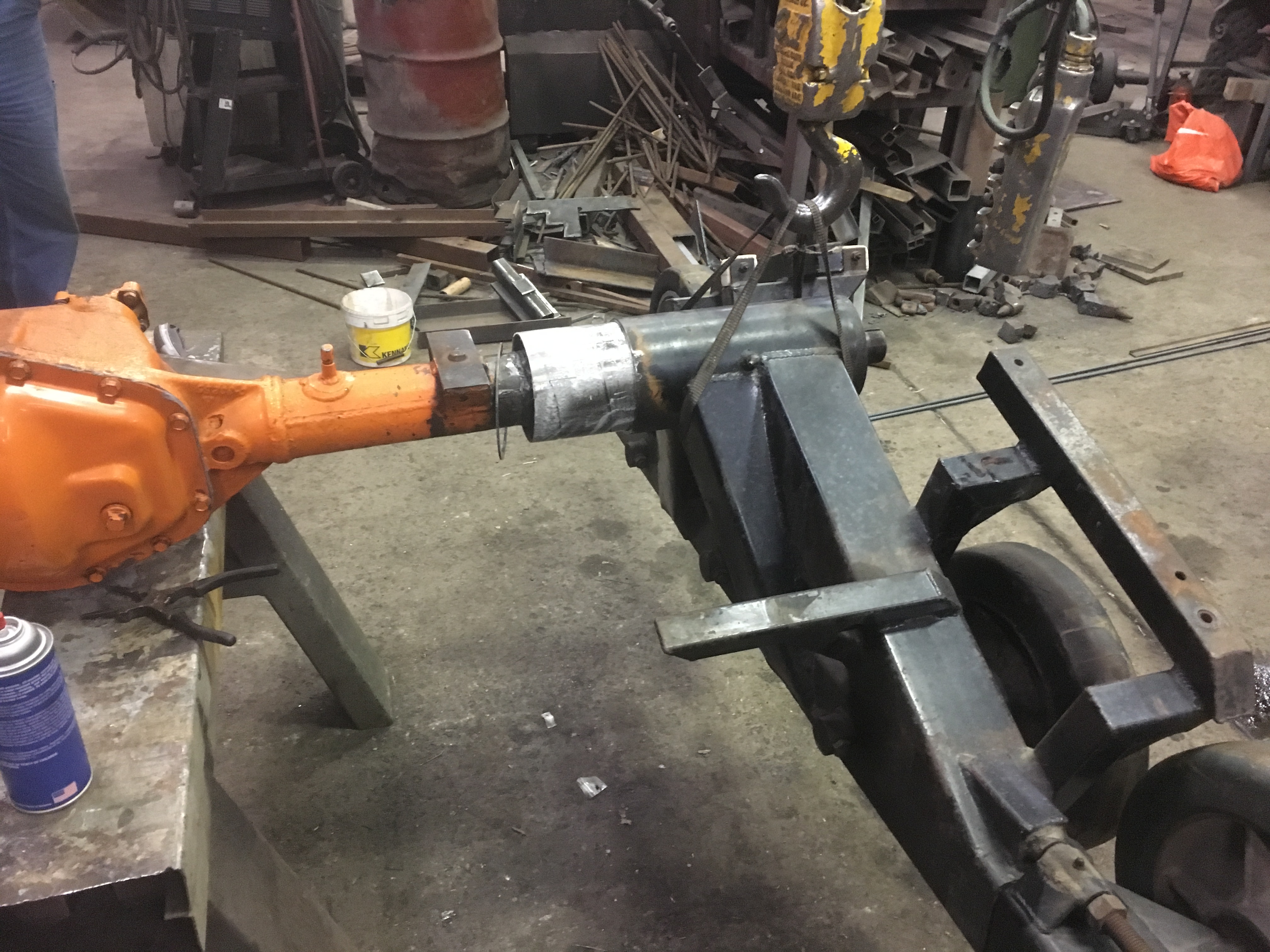

As you probably know, the carriers on Tuckers rotate about the axle. Here’s a pic. You can see the carrier partially installed on the axle housing. This is a 1500 series carrier, so mid-length. Look on the differential side of the carrier in the foreground. You’ll see an arm that's perpendicular to the carrier. That arm is a rotational stop and there is another on the front of the carrier. When carriers are installed on a snowcat, those rotational stops contact the leaf springs and limit the carrier’s ability to rotate, so the tracks physically can’t hit the cab.
Here’s a different view and you can see the proximity of the rotational stops to the leaf spring packs. If you look closely you’ll see the same stops on the rear carrier. If the rotational stops have been cut off or bent, then yes, the tracks could hit the cab.
